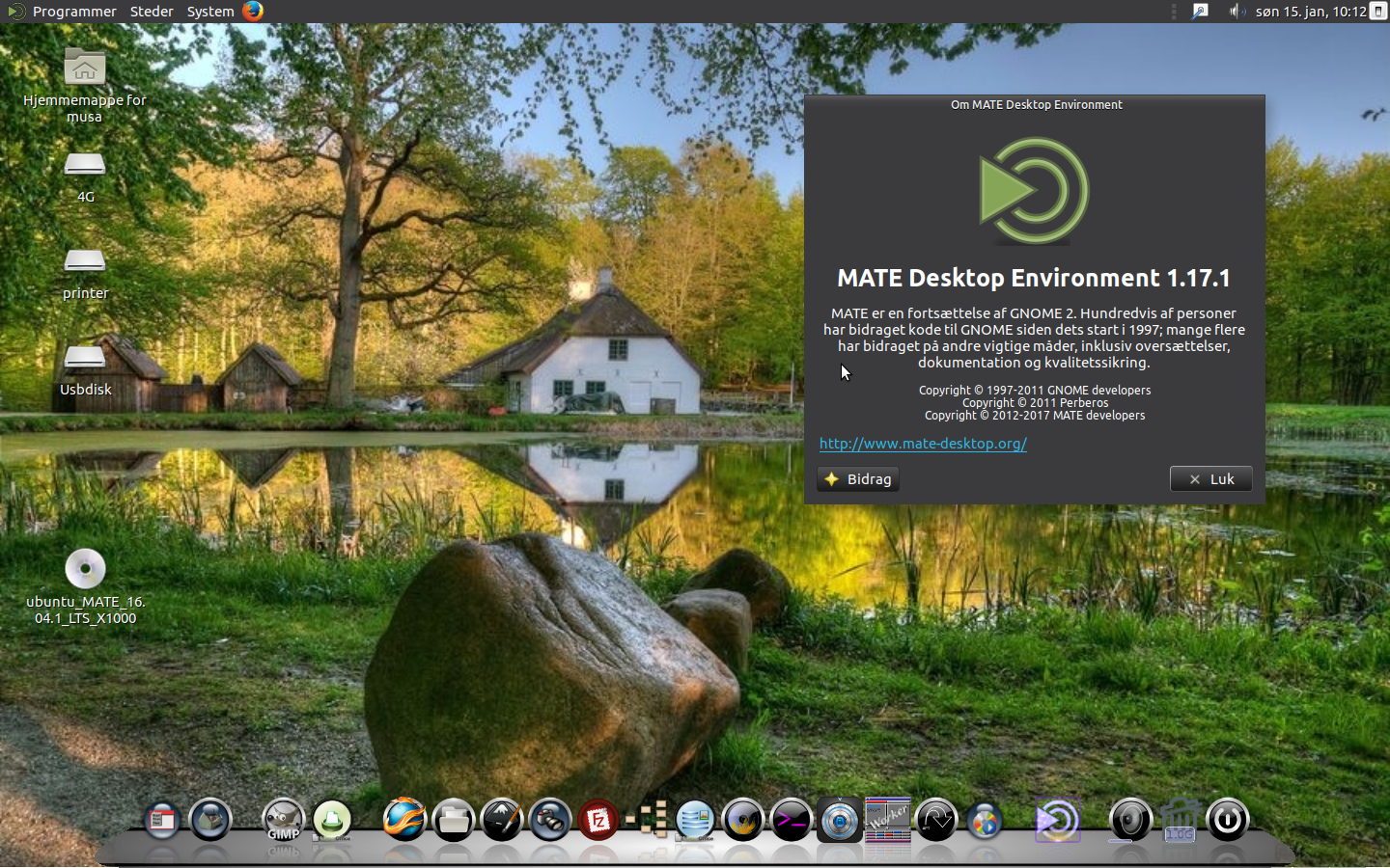

Re: (X)(L)ubuntu (MATE) 17.04 Zesty Zapus
Upgraded to Mate desktop 1.17.1
Posts: 11064
musa wrote:Upgraded to Mate desktop 1.17.1
Fantastic! :-) Thank you for posting the screenshot. :-)
