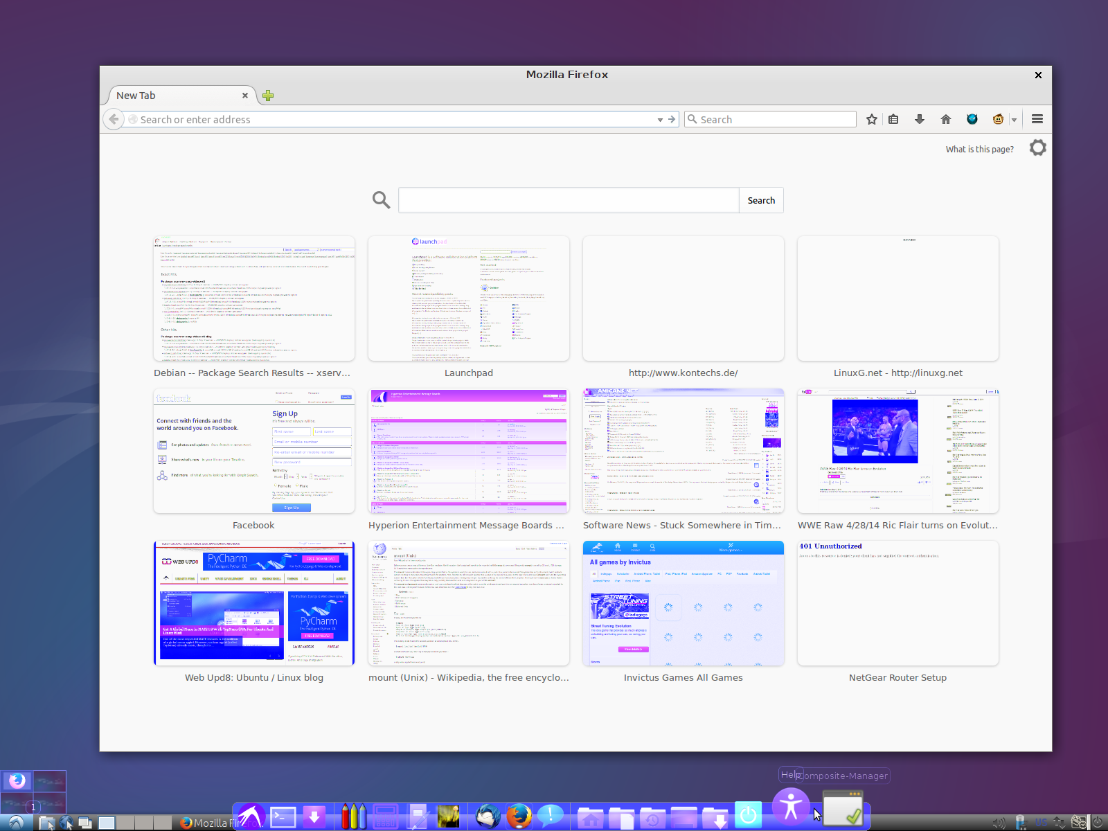

Wrong colors in Firefox 35 start page (new tab) and on Cairo-dock. Tested on Lubuntu developmental 15.04.
Posts: 11519
Re: Mesa 9.2.2-1 and 10.0.0-1
Srtest wrote:Wrong colors in Firefox 35 start page (new tab) and on Cairo-dock. Tested on Lubuntu developmental 15.04.
Do you use the unofficial Mesa system-wide? Can you activate compositing?
