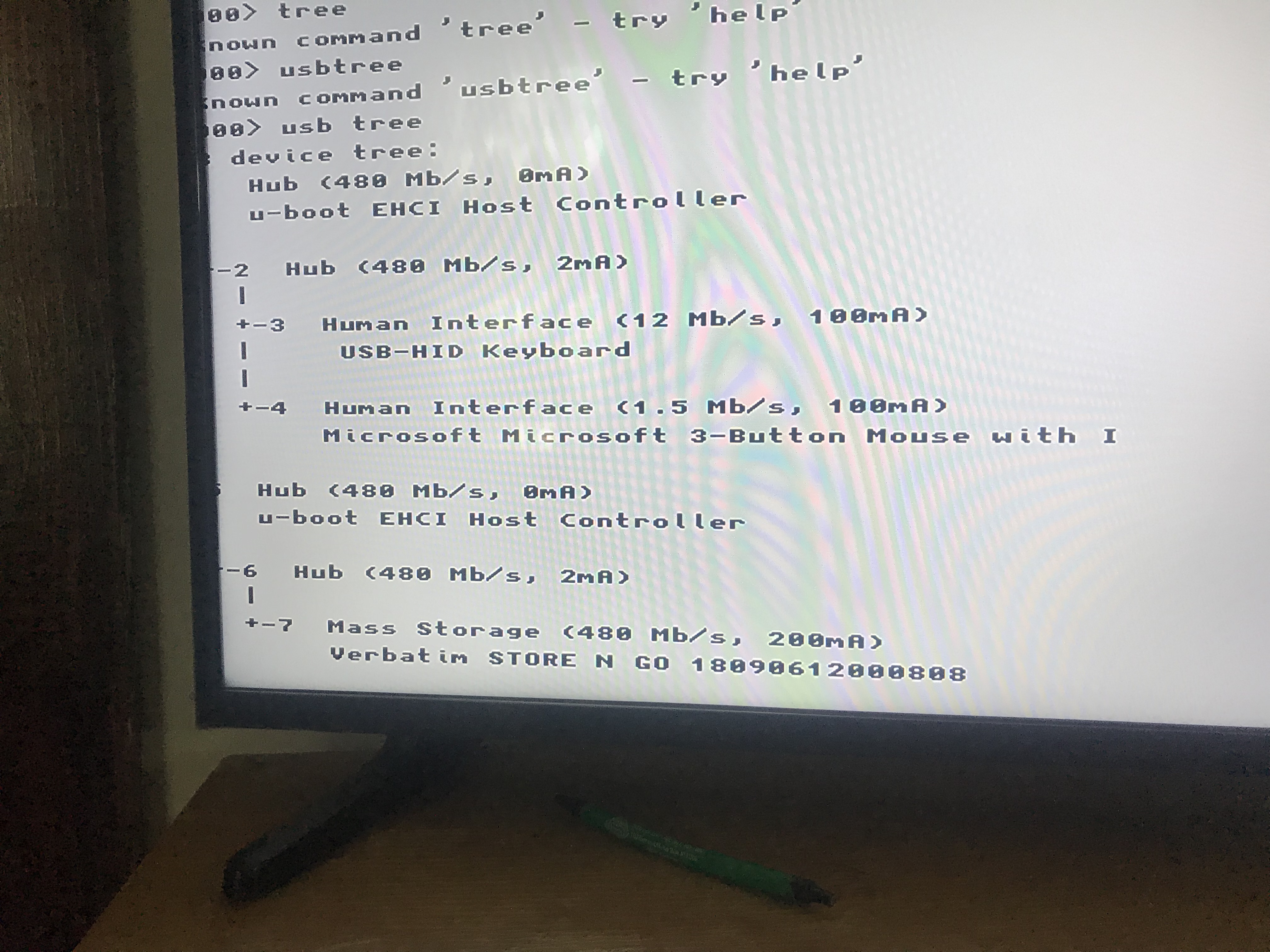

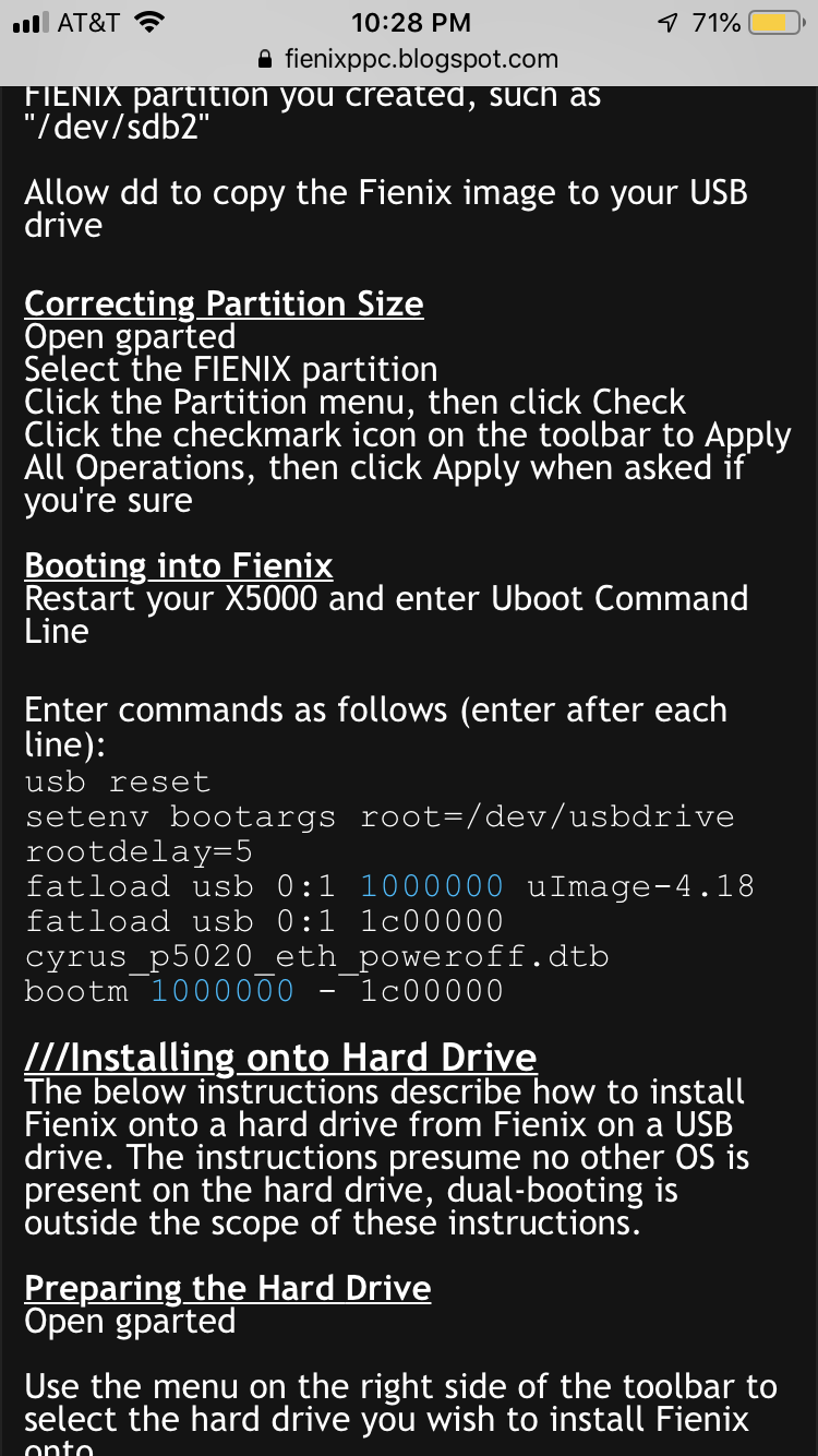

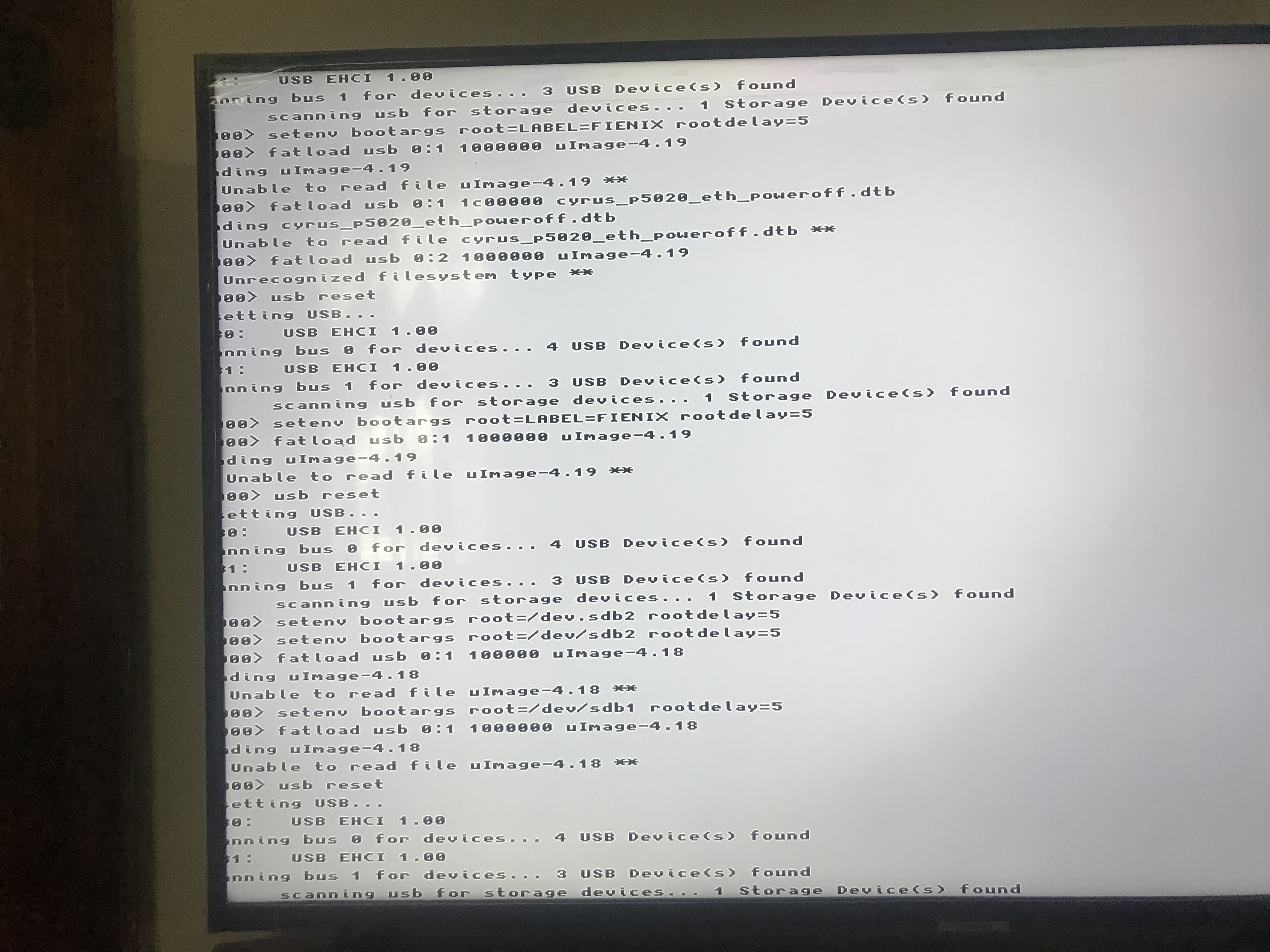

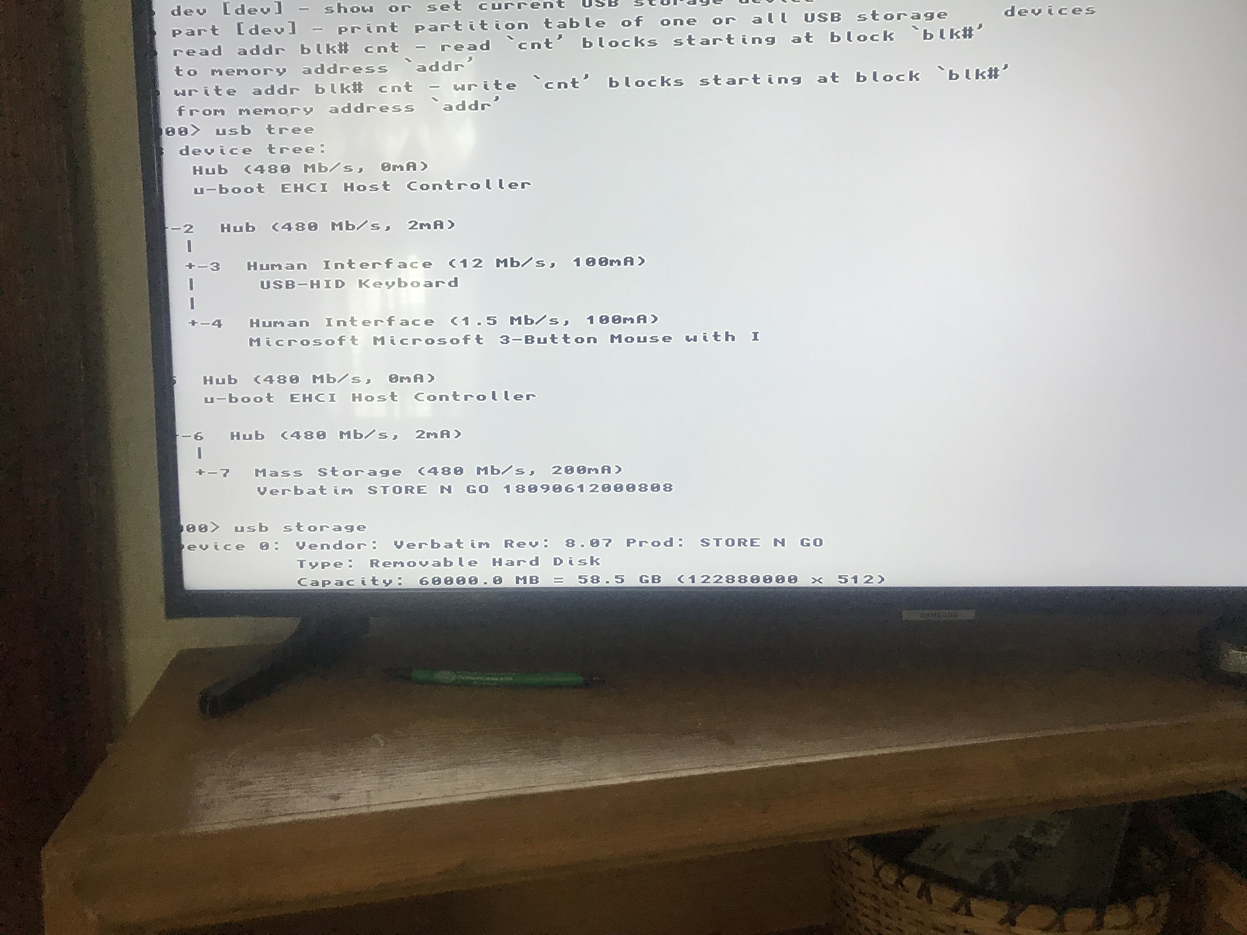

Hi ok so everything on usb was sda1/2 respectively.but tells me reading file then not found.designation was from the Linux prep .This is for the Fienix usb install.ok so it is just #7 on that device tree.stil can’t gett it to boot up says file not found ,using the uboot instructions from the Fienix download site any ideas. Using 0:1 says unable to read file uimage-4.18**.trying usb 0:2 says unrecognized file system type.

What are the commands you are entering?
Tijatjj wrote:Hi ok so everything on usb was sda1/2 respectively.but tells me reading file then not found.designation was from the Linux prep .This is for the Fienix usb install.ok so it is just #7 on that device tree.stil can’t gett it to boot up says file not found ,using the uboot instructions from the Fienix download site any ideas. Using 0:1 says unable to read file uimage-4.18**.trying usb 0:2 says unrecognized file system type.

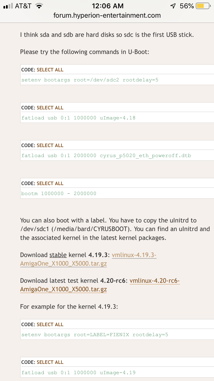

Hi thanks, the commands are the ones from the Fienix website but I just looked at the. Partition of the usb and it’s sdb1 and sdb2 so made mistake right there.als addedto cyrus boot the4.19 file from pictures

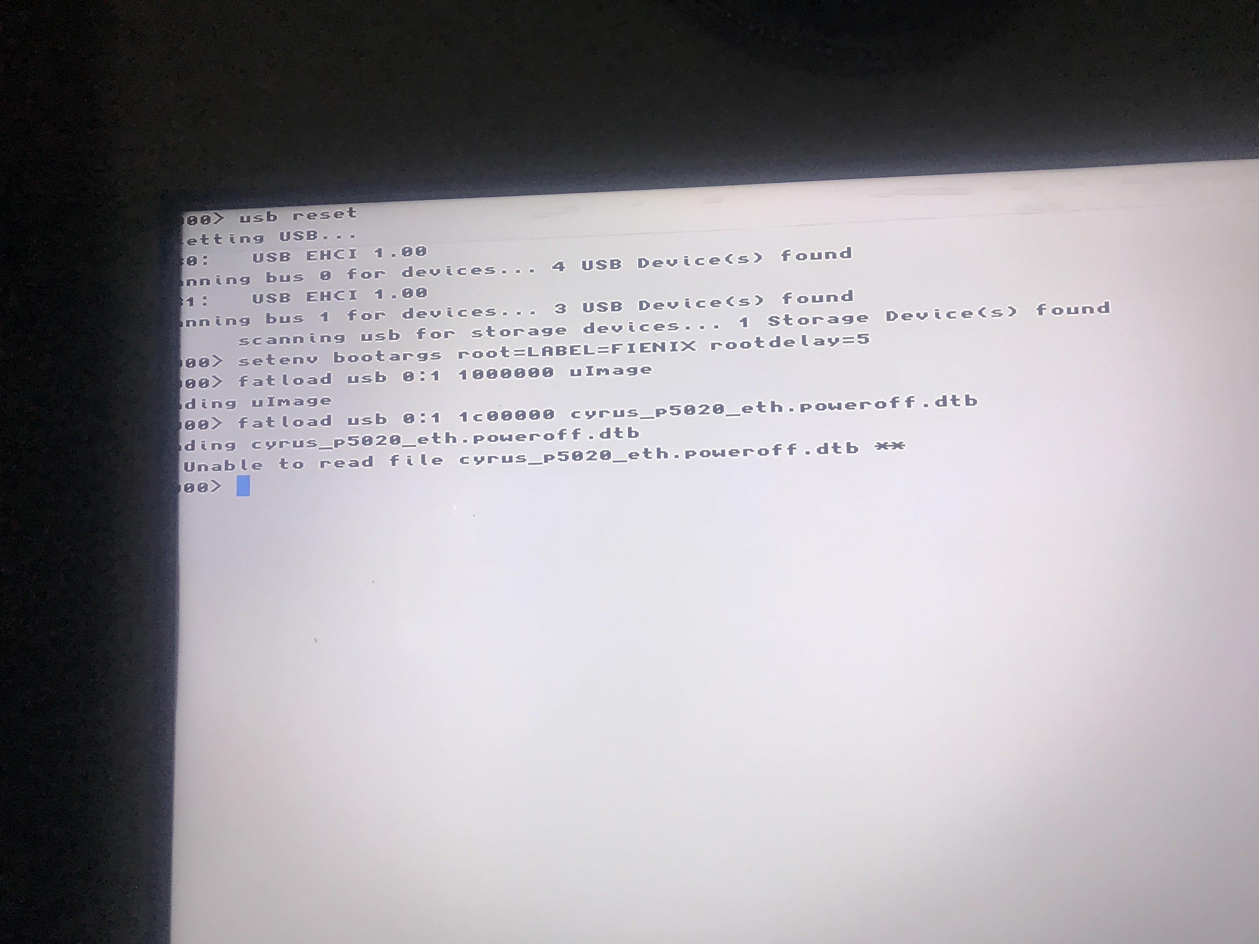

Ok so here is what’s tried ,did try w/ correctly spelling pic and here’s pic of 64 gig usb drive.stiil not working to install on usb also have hd open to place it into.
Posts: 11064
Please rename uImage-4.19 to uImage and try it again.
— Christian

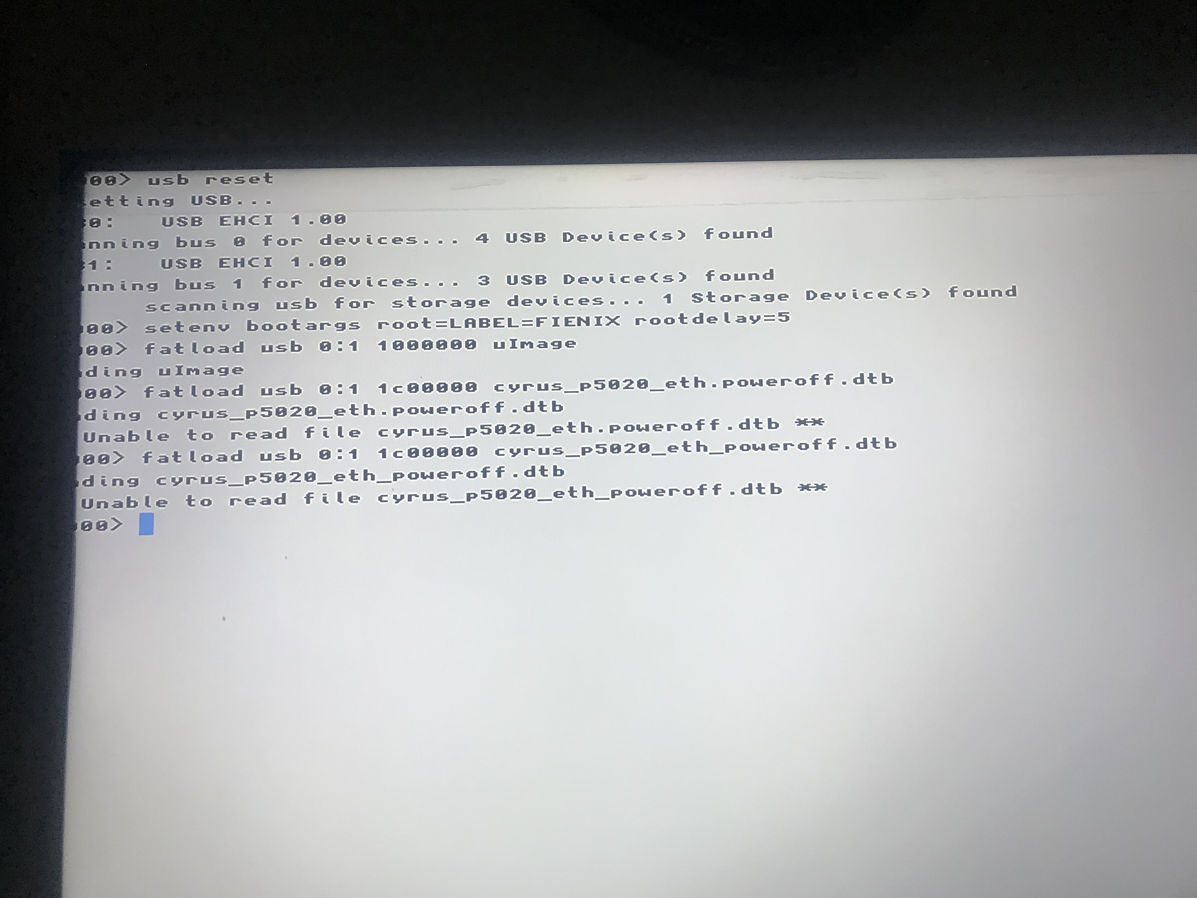

Tijatjj
Posts: 159
Post by Tijatjj »

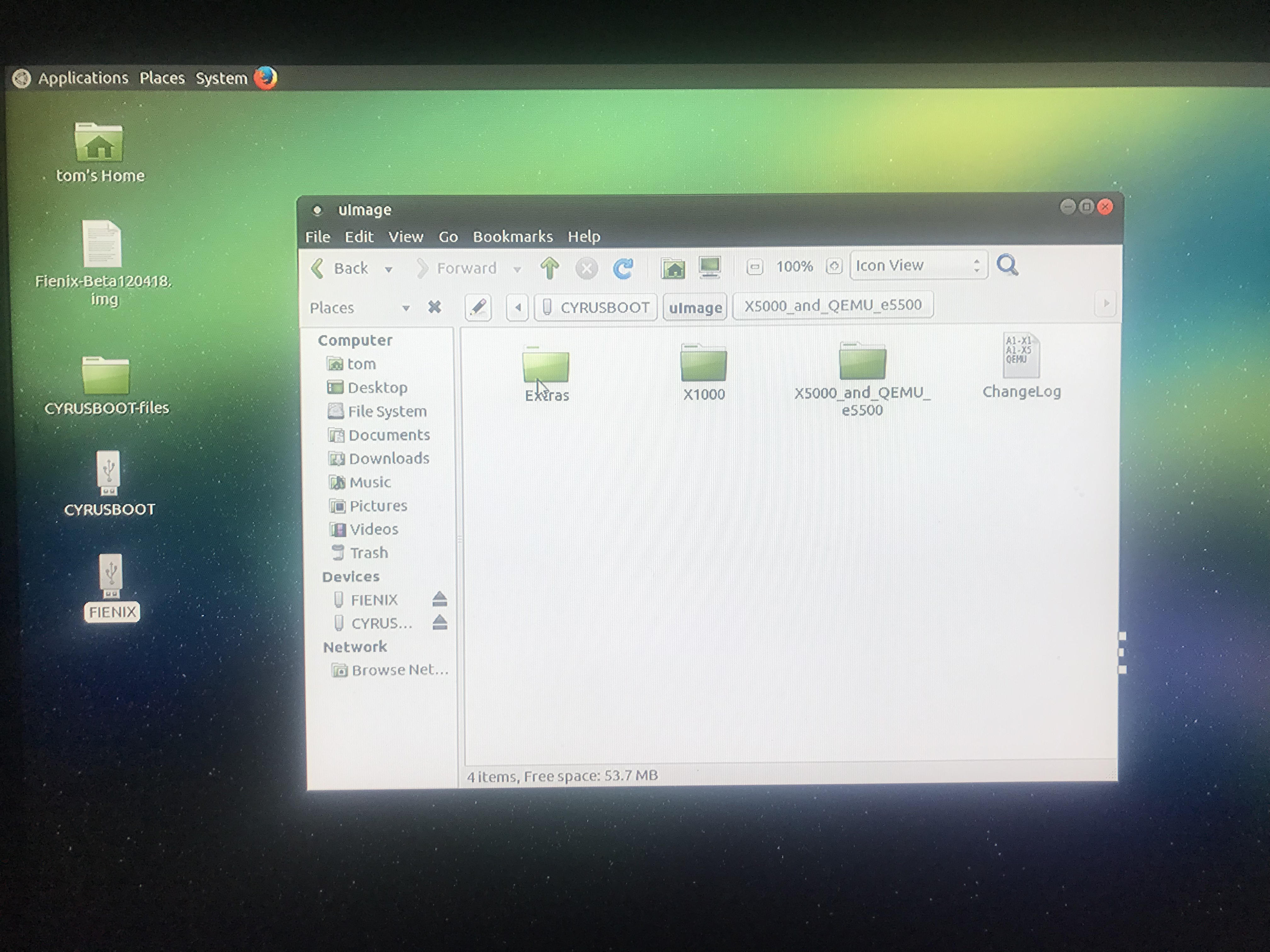

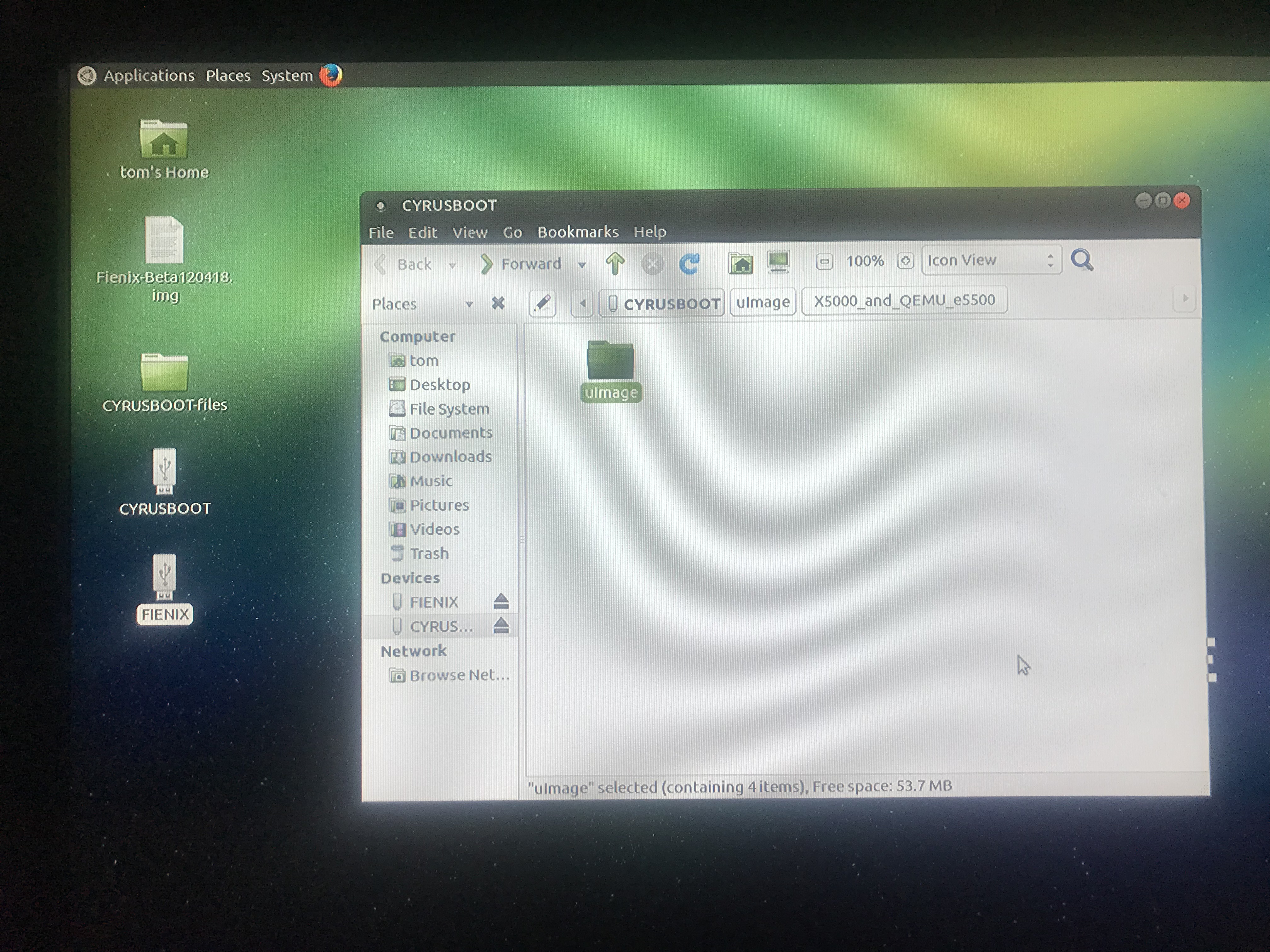

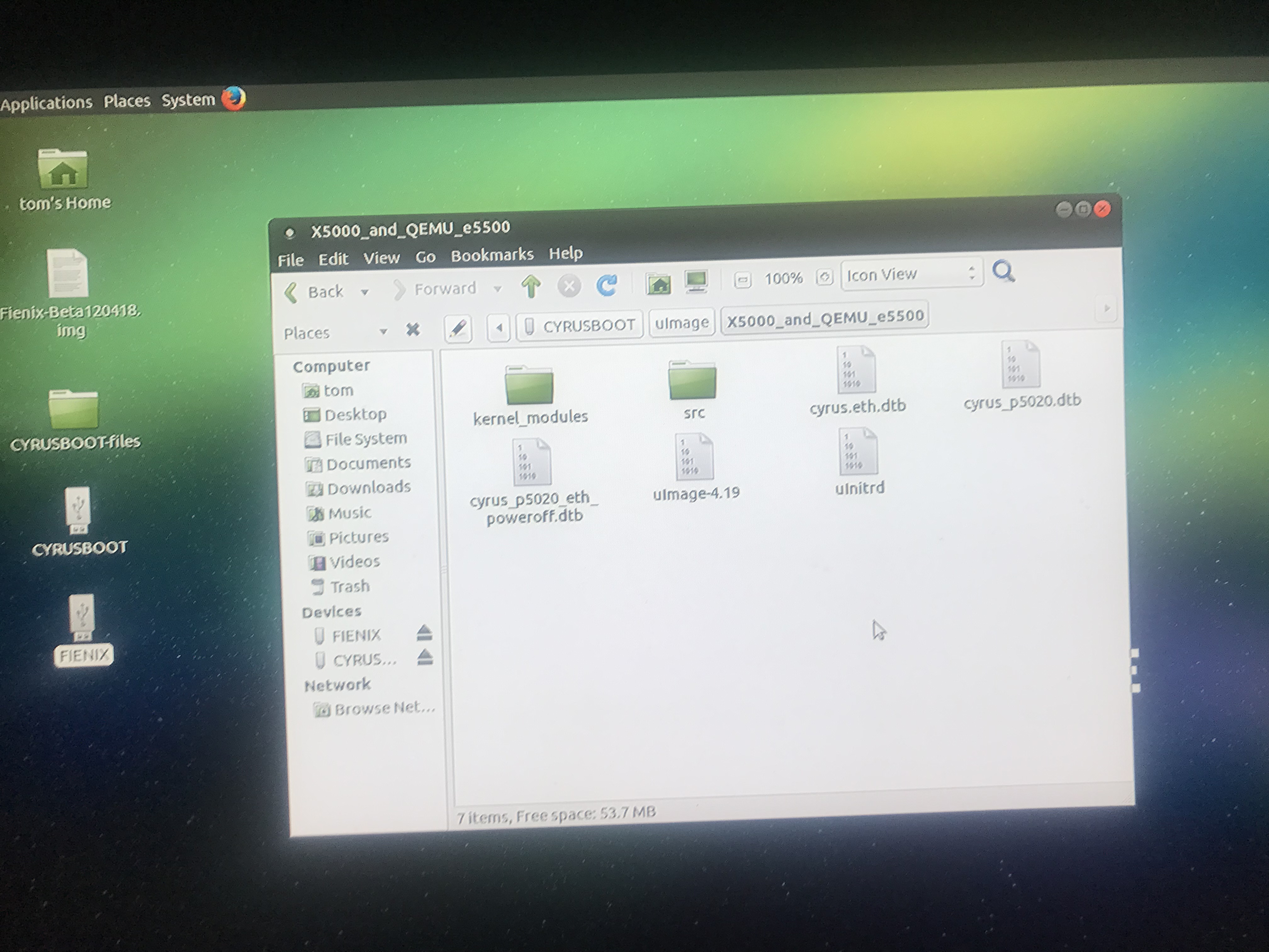

Ok that partly works but it says reading Cyrus file then unable to read file. Pics of the Cyrus partition boot files in there folders I redid it with correct spelling same thing
Tijatjj
Posts: 159
Post by Tijatjj »
Sub folders
Posts: 11064
Hi Tijatjj,
You tried to boot a folder. This doesn’t work. Please copy only the uImage-4.19 and the cyrus_p5020_eth_poweroff.dtb to the FAT32 partition and delete the folders.
