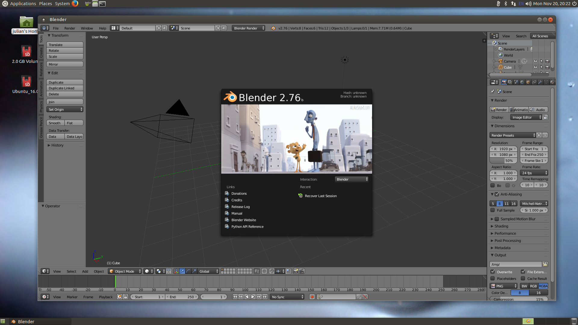

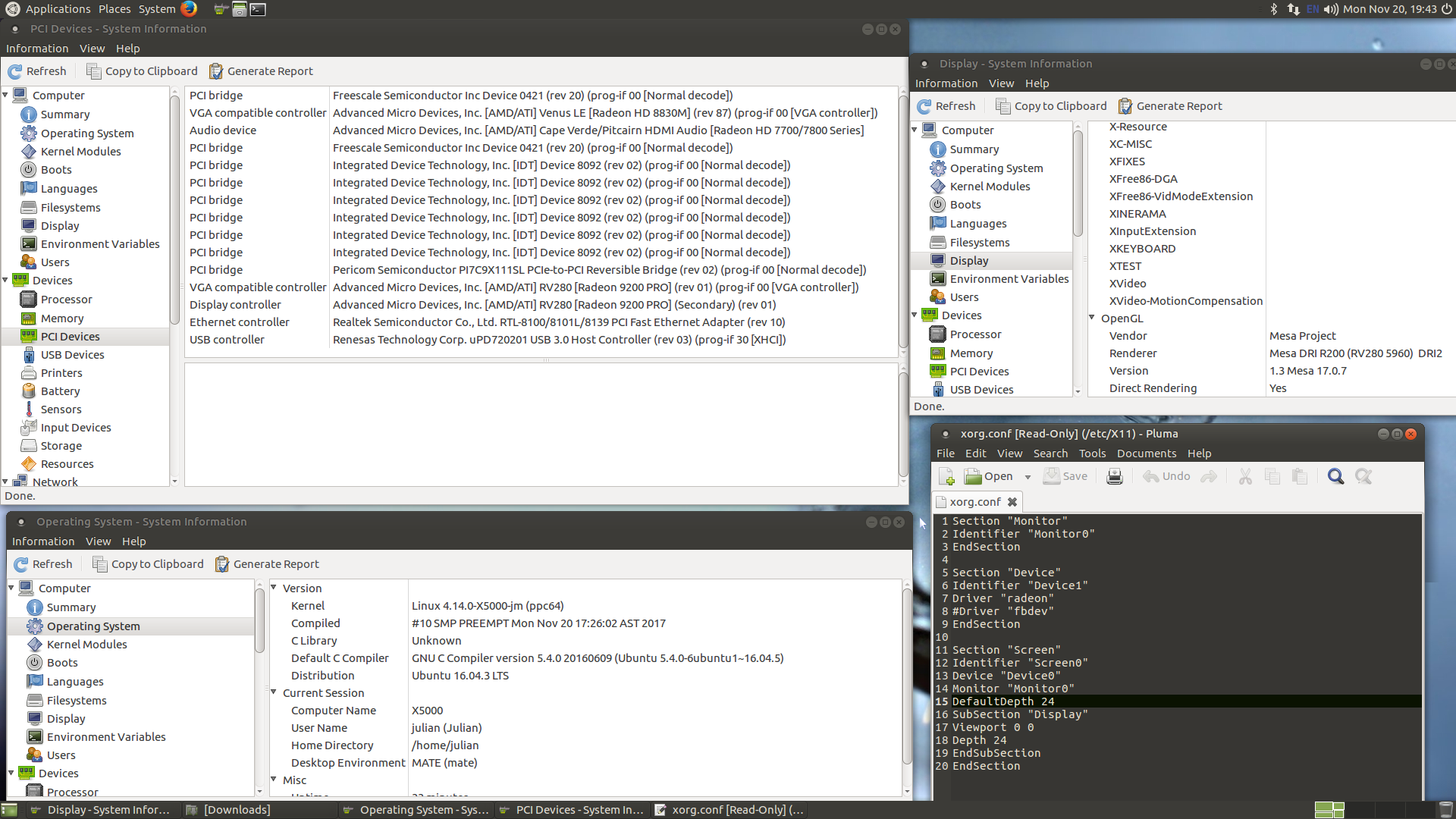

Todays project. With Ubuntu Mate 16.04 .
Radeon 9250 pci with 3D Acceleration under Linux.
Faster than llvmpipe with a Radeon SI card.
Blender GUI runs with this .
My Radeon R7-250 stays in the X5000 and works under AmgaOS 4.1.
Configuration is using 1 monitor.
Radeon R-7250 connect to HDMI and Radeon 9250 connected to DVI .
Initial display is on HDMI then switches to DVI when xorg loads.
Needs my new version of the 4.14.0 kernel with the firmware for the old Radeon 7000 and 9250 pci cards .
http://dl.dropboxusercontent.com/s/39nl ... ar.gz?dl=0
And the modified xorg.config as displayed in image #2
http://dl.dropboxusercontent.com/s/ryat ... .conf?dl=0
Edit:
Or rename the xorg.conf to xorg.conf.bak and boot without an xorg.conf (Might be the best option)
