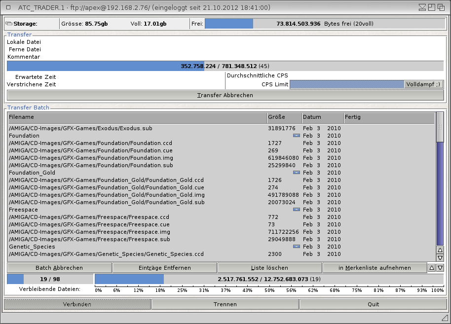

Re: Ethernet not so stable?
<offtopic>
Any idea why inside the AmiTrader some fields are plain without any text?
</offtopic>
</offtopic>
- Attachments
- AmiTradeCenter
- (130.68 KiB) Downloaded 2238 times
It could be that the text colour being used is the same as the background colour. Try changing some pen colours in MUI prefs. (BTW, this is not my idea, so I can't take any credit for it.)apex wrote:Any idea why inside the AmiTrader some fields are plain without any text?
