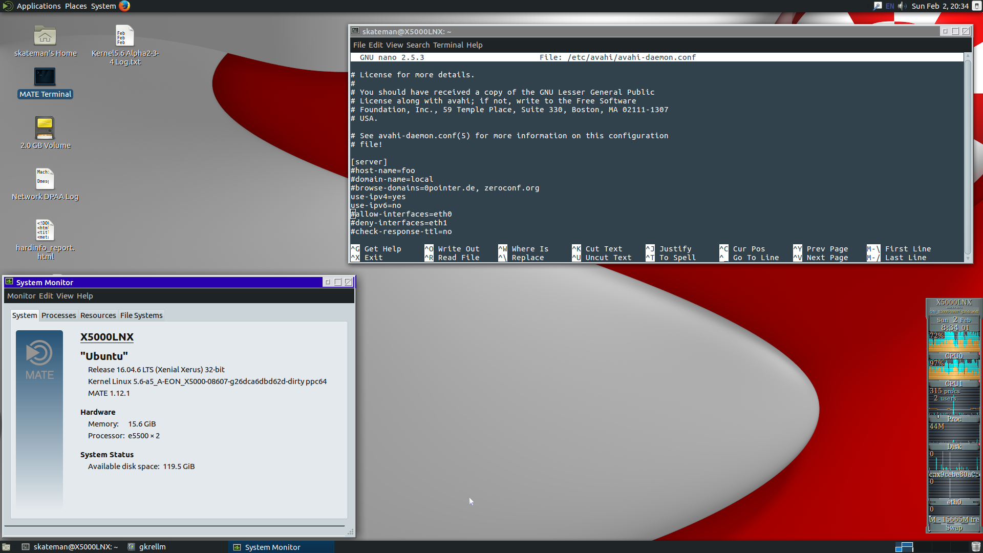

Re: Kernel 5.6
Kernel 5.6 Alpha5 running on the AmigaOne X5000
Big picture http://www.skateman.nl/wp-content/uploa ... 203401.png
Alpha 5 has like mentioned by Christian the high CPU issues caused by the avahi-daemon.
Setting the value use-ipv6=no does NOT solve the problem for me and the high CPU usage remains.
Disabling the avahi-daemon using sudo service avahi-daemon stop does solve the issue!
