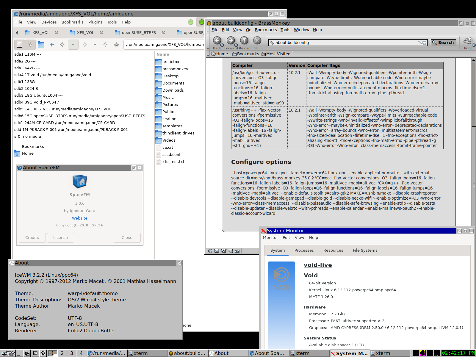

xeno74 wrote: Sat Mar 18, 2023 11:30 am Hi All,
I was able to update Void in the root disk image yesterday. I think, this is the last Void disk image. Please change to Fienix in the future.
  • Noboot disk image (image without boot partition)
  • Fbdev is pre-configured
  • Renamed the libglamoregl.so to libglamoregl.so.bak
  • Yaru themes
  • Arctic Fox 40.1
  • Pale Moon 31.2
Download: void-live-powerpc-20230317.img.tar.gz (md5sum: 9e663d6045ffc24e58b7adbd4b9c9629)
If you want to enable hardware acceleration manually, then edit the file /etc/X11/xorg.conf. Change the "driver" from fbdev to radeon.
md5sum void-live-powerpc-20230317.img.tar.gz
49d2ae2c8999575280ff235bcb39dfc8
du -sh void-live-powerpc-20230317.img.tar.gz 4G
du -sh void-live-powerpc-20230317.img 13G
