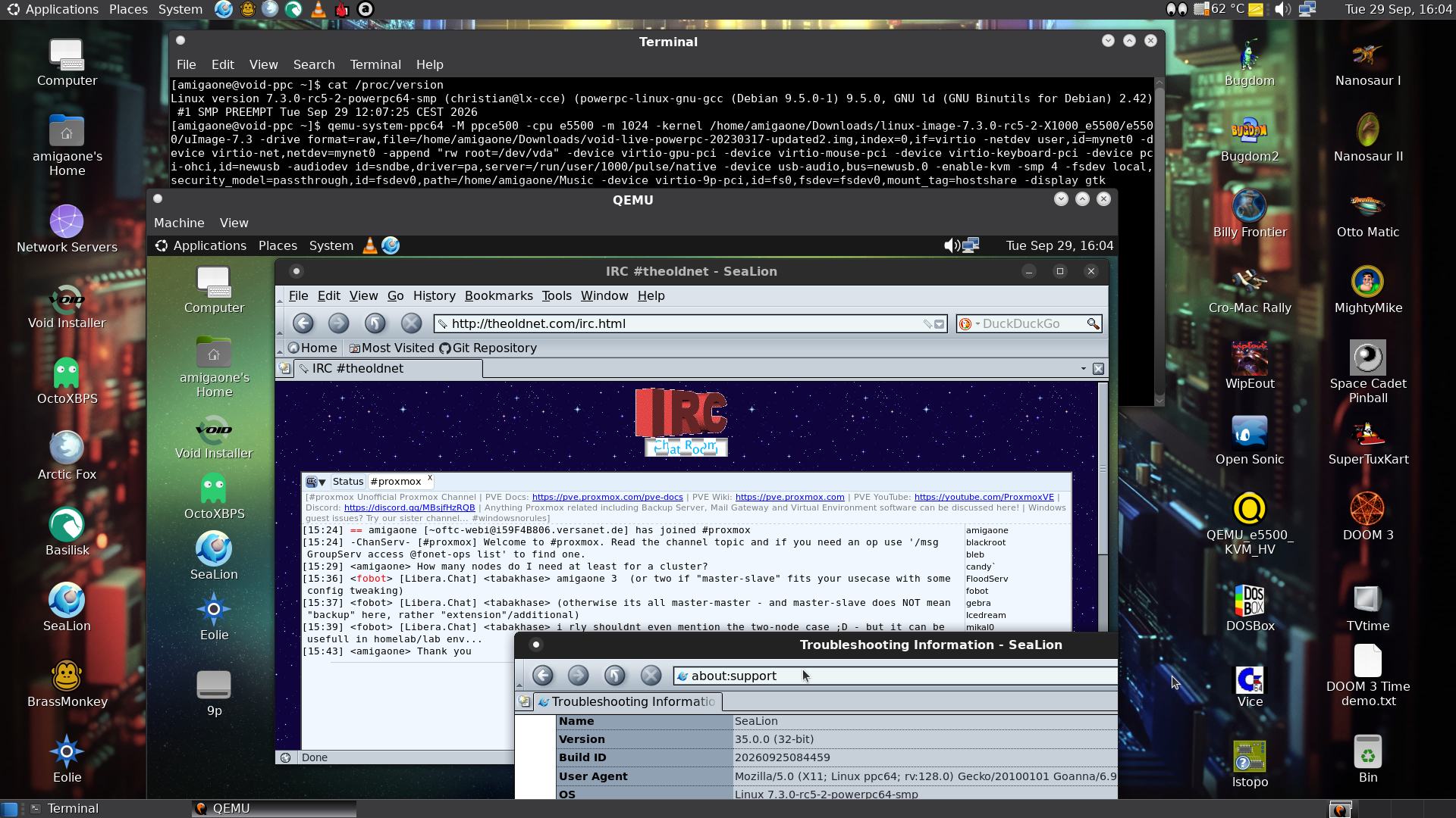

The issues with KVM PR and KVM HV on PREEMPT kernels have been resolved.
Further information: KVM PR and KVM HV do not work if the kernel was compiled with PREEMPT
#19
Here is the RC4 of kernel 7.3 with PREEMPT activated for testing.
Download: github.com
Kernel 7.3-rc4 with PREEMPT activated with KVM HV on an X5000/40:
Please test the PREEMPT kernels.

I have released the RC5 of kernel 7.3 with PREEMPT support for X1000 and e5500 machines (X5000/20, X5000/40, Mirari, and QEMU VMs).
PREEMPT lets the Linux kernel stop one task and quickly give the CPU to another task. It makes Linux respond faster to important tasks instead of making them wait.

I compiled the RC5 of kernel 7.3 with new PREEMPT patches for testing yesterday.
