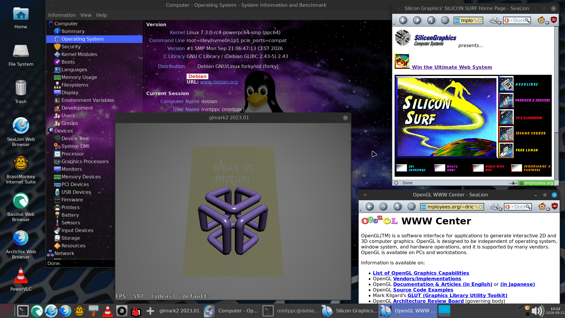

I released the RC3 of kernel 7.3 for X1000 and e5500 machines (X5000/20, X5000/40, Mirari, and QEMU VMs) today.
The RC3 of kernel 7.3 with the new B650 SouthBridge (setenv bootargs root=/dev/nvme0n1p1 pcie_ports=compat):
