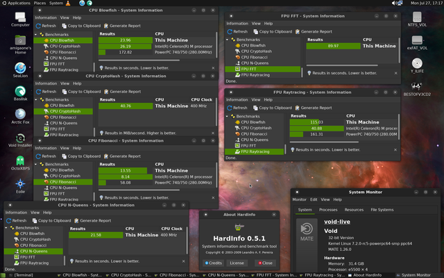

I have released the RC5 of kernel 7.2 for X1000 and e5500 machines (X5000/20, X5000/40, Mirari, and QEMU VMs).

I modified the pas_pci_init patch and compiled the RC5 of kernel 7.2 with this patch again today.
