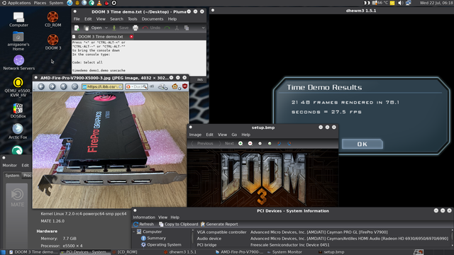

Posts: 11453
Re: dhewm3 (Doom3)
Video Quality: ULTRA QUALITY
Screen Size: 1280x1024
Fullscreen: NO
Antialiasing: 8 x
All advanced options enabled
Results:
AmigaOne X5000/40 4 x 2200.00 MHz with an AMD FirePRO V7900 (Cayman PRO GL) (Void PPC): 2148 frames rendered in 78.1 seconds = 27.5 fps
