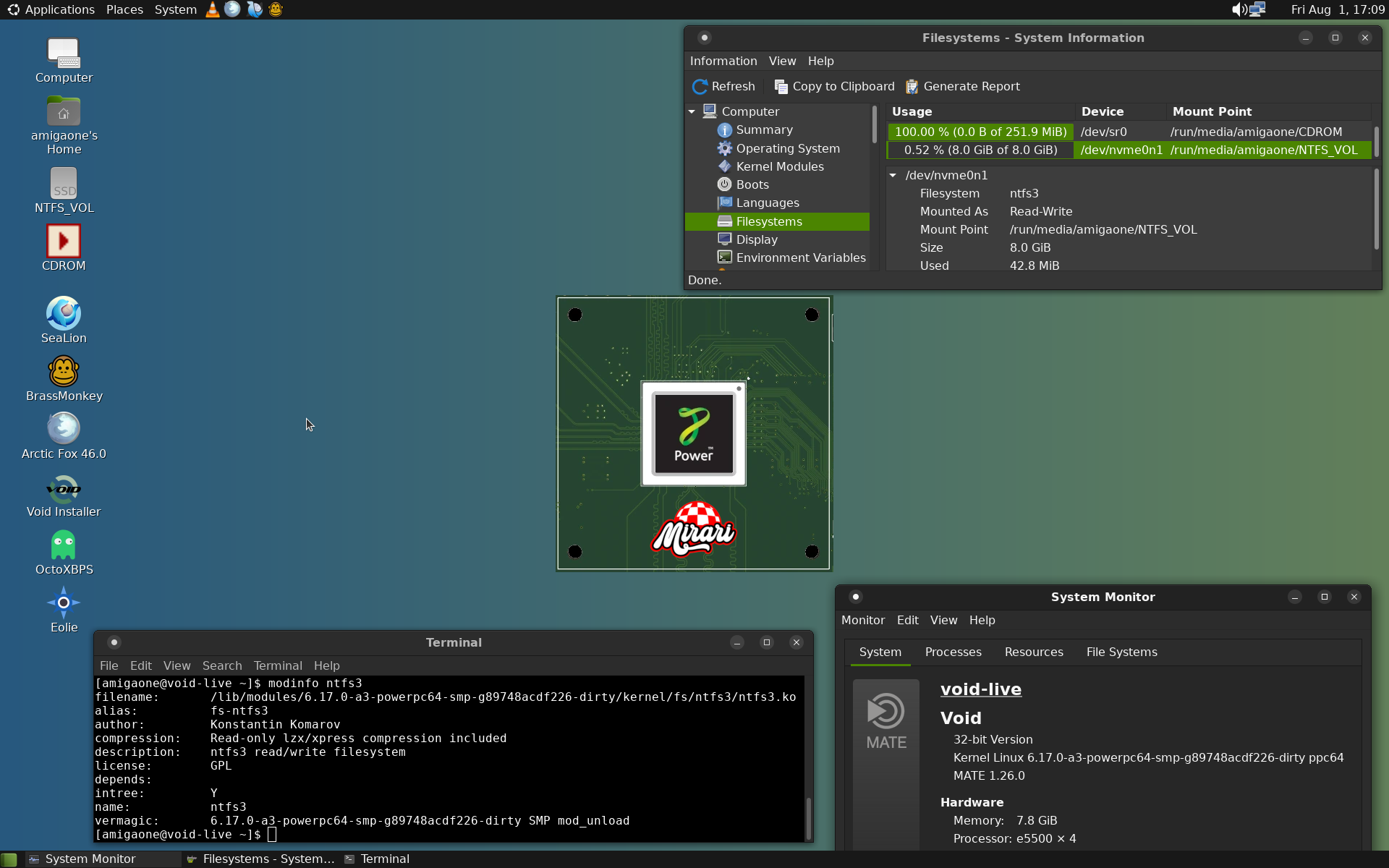

Okay so I've done some testing over the past couple of days.
Because I can be a rather sequential person I also tested the alpha 4. Both vmlinux-6.17 and vmlinux-6.17-2. As expected breaks on Radeon but could log in from serial and grab logs.
Next tested the alpha 5. Both vmlinux-6.17-1 and vmlinux-6.17-2. Dash-1 failed to load screen. Dash-2 works! So vmlinux-6.17-2 is functional. :-)
I had to check I had the right versions. Because there was no vmlinux-6.17-1 in alpha 4 I got confused. I had a vmlinux-6.17-1 in alpha 5 and a vmlinux-6.17-2 in alpha 4. I didn't know what was going on! Then I checked all the files to see how it had ended up backwards. :-D
So some notes about the alpha 5 archive. It lacks the expected 6.17 kernel files and only had dash-1 and dash-2 kernels. But it also lacks modules. So alpha 5 kernel can work but no modules are included. Is this intentional for the alpha 5 archive?
