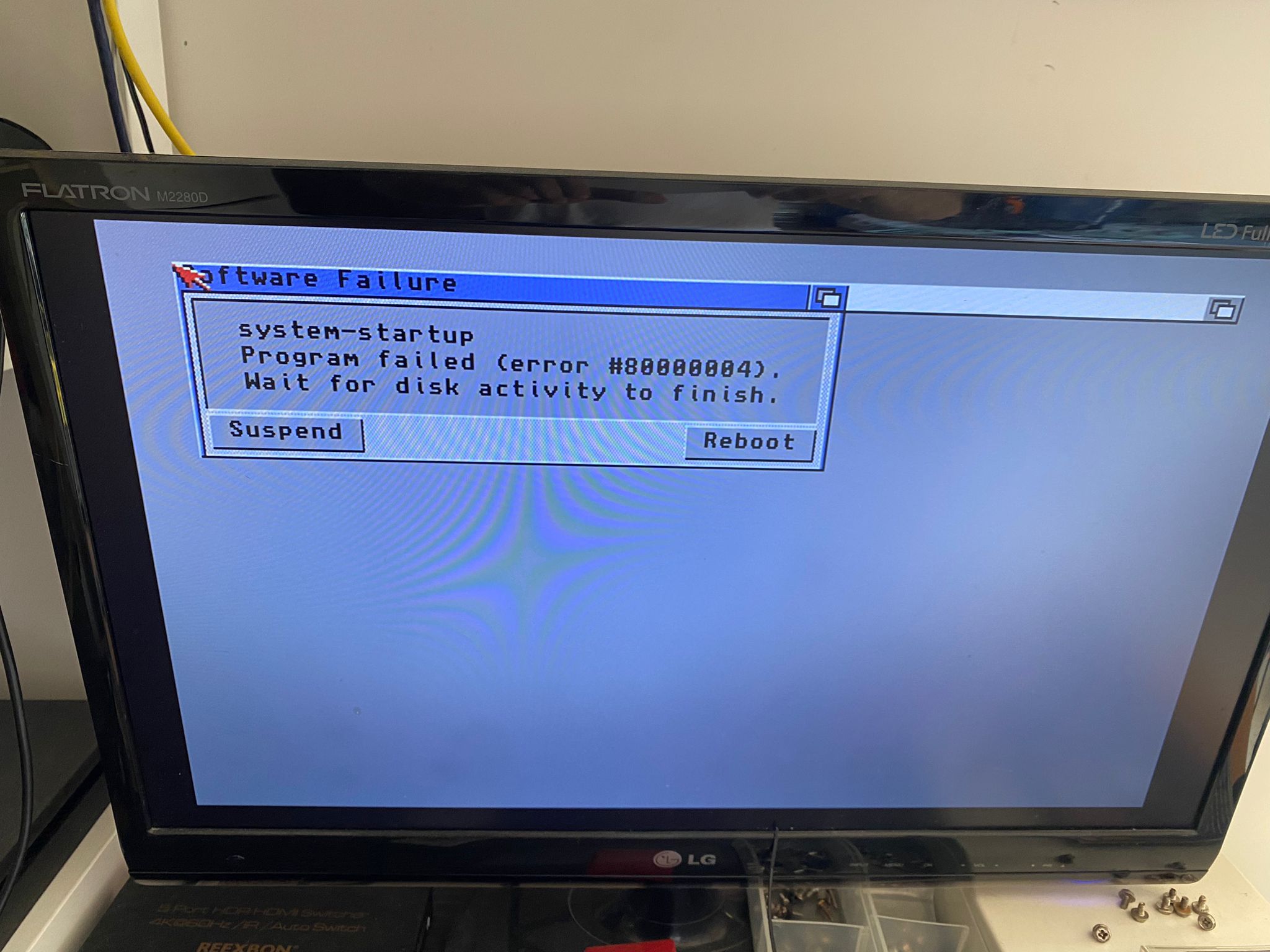

i finally was able to install AmigaOS 4.1FE on my Amiga 4000, had to unplug the whole SCSI chain so used the IDE port.
I have both Pio2 hack and 64mb hack.
I was able to install properly, the system boots from CD nicely and complete the installation but then ì boot from the IDE device (an SD industrial memory) i get the error message attached.
What could be the problem?
Pio2 hack, 64mb hack or what else?

if system-startup is a script, like startup-sequence, you could place a
"set echo on"
on top of it and see where it stops.
it looks like some program started from within the script is crashing

Re: amigaOS 4.1 FE and A4000 64mb Hack
i'm just guessing here but i remember failing the first time i attempted to install os4 classic many years ago and probably ended up with something similar.
The problem was that i failed to install the filesystem properly, i think i wrongly assumed that media toolbox would add sfs to the rdb.

System-startup is not a script. It is a new component in Kick 3.2 or higher. It is completely unrelated to OS4. Does WB 3.2 run on this computer or does it crash, too? Are you sure you boot from the OS4 partition? Did you ever get this machine to boot into any OS version with this Kickstart?
