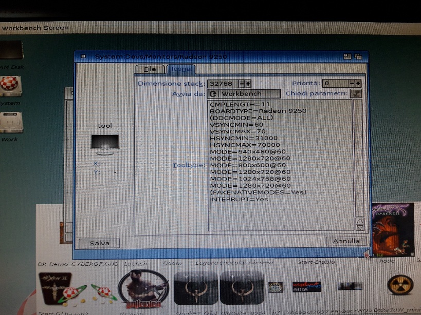

Try / check the tooltype, the following example is of my Radeon 9250 pci on the Sam440; in particolar i observated the Interrupt tooltype difference on the bvision of Classic 1200 the interrupt=No , on the Radeon 9250 in the Sam it's Yes :
I tired changing the interrupts to on or off and those other parameters that you showed in the screenshot like CMPLENGTH to 11. But it gives the same result. The screen gets disturbed with some stripes after a short period. I think I'll have to give up on this. It must be a driver issue and I don't see any working solution for a Mediator system. The only thing I can get to work is with a Voodoo card but that's before Update 1. After update 1 that card stopped working.
