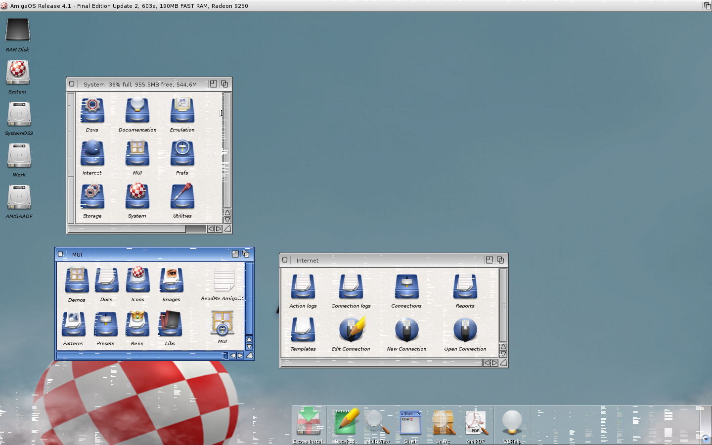

I have an issue with a Radeon card on my setup. It shows some white stripes on the screen. From a cold start, the image can look very clear, but if you start to open windows or programs, suddenly the white stripes appear. First in the small and then they are pretty much everywhere. And finally, the whole system will freeze. A soft reset does not remove the white stripes, but if I shut down the computer and leave it off for a while before starting it again the strips has gone. But quickly returns again if you open some windows or a program.
I have tried a clean install of OS 4.1 FE and with update 1 and 2 but the result is the same.
I have attached a screenshot that I took with SGrab.

Hi I think it could be a hardware problem. Are you able to test the card on an old PC? Or I use a Radeon 9250 on the Sam440 and it works fine. Try to buy this: https://www.ebay.it/itm/254824405336thoby wrote: Mon Feb 01, 2021 1:48 pm Hi

I have tested the card on OS 3.9 and it seems to be working fine. I did also test with another card a Radeon 9250 that I use in a Sam440ep.This card also seem to show the same pattern when I use it on the A1200.
The card you refering to in the link seems to be an AGP and PCI at least if you look at the pictures.

They are not "extra". You should edit the original 1440×900 mode line - first try with +RB, then if that doesn't work, try with -RB instead. But don't leave any other 1440×900 mode while you try it.thoby wrote: Thu Feb 11, 2021 7:06 amBut unfortunately adding those extra modes did not do the trick.
Re: Amiga OS4.1FE Classic and Radeon card issue.
Thanks for the tip. I tried both combinations but the result was the same. Those white strips keep popping up. I find it really strange that the card works fine under OS3.9 but not on OS4.1. From what I can read there and elsewhere it seems like the most common issue is to find a card with the correct voltage that works with the Mediator.nbache wrote: Thu Feb 11, 2021 12:15 pmThey are not "extra". You should edit the original 1440×900 mode line - first try with +RB, then if that doesn't work, try with -RB instead. But don't leave any other 1440×900 mode while you try it.thoby wrote: Thu Feb 11, 2021 7:06 amBut unfortunately adding those extra modes did not do the trick.
