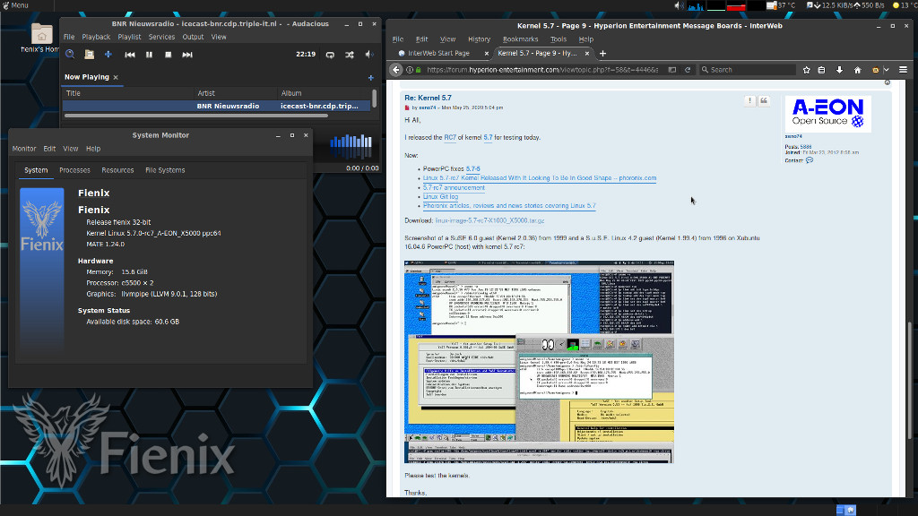

Posts: 590
Re: Kernel 5.7
Kernel 5.7 RC7 up and running on the AmigaOne X5000
Big picture http://www.skateman.nl/wp-content/uploa ... -27-41.png
