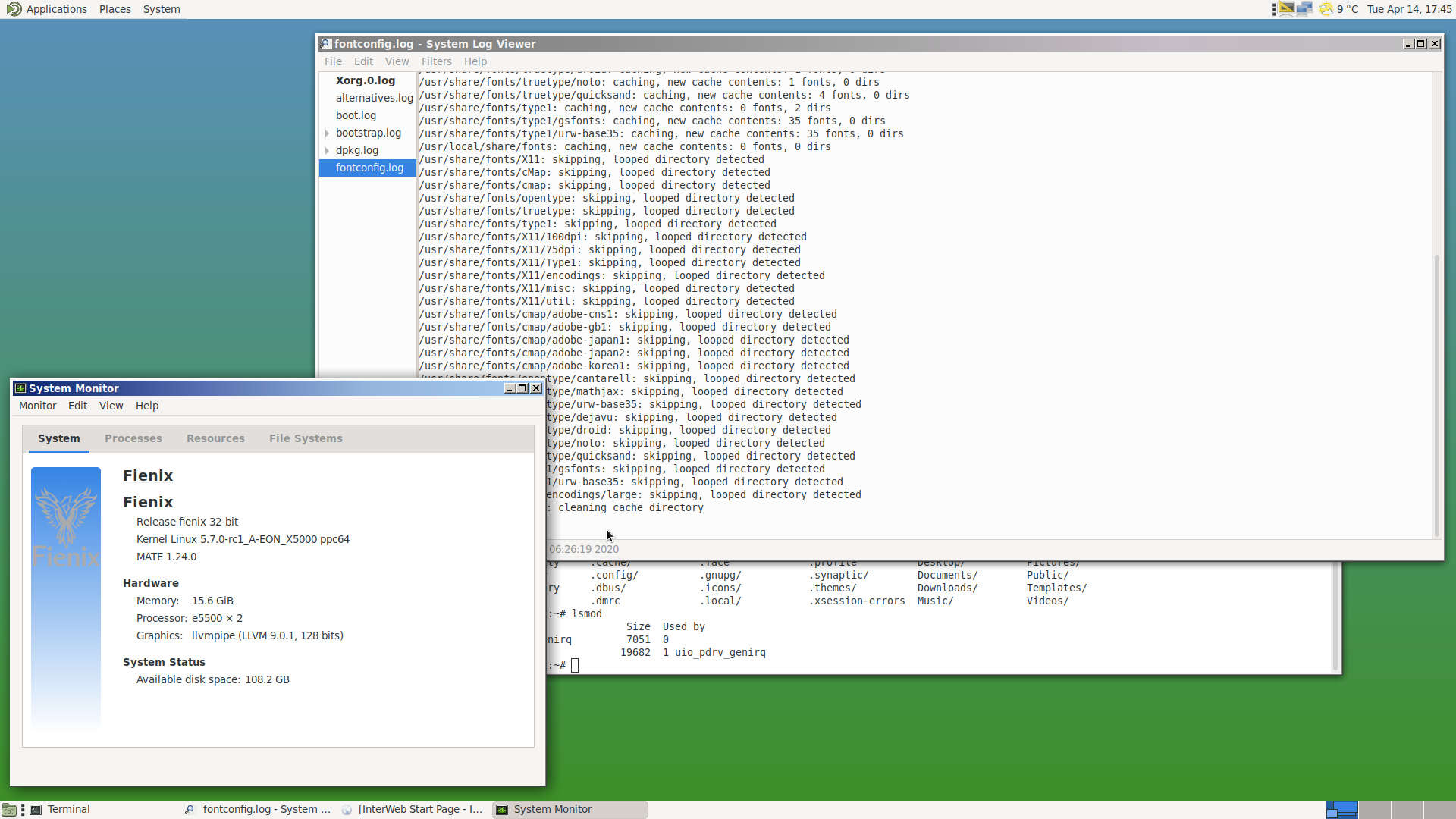

Posts: 864
It has been renamed to .bak already.
I have copied my Xorg.conf from my ubuntu linux to Fienix. The Welcome screen shows up... i can login as fienix...
After login the screen turns to black again... mouse pointer still visible and responsive
All is running, can switch to a different TTY and work without the GUI in fienix.
It has to be something with the display drivers..
Let me fiddle a bit more...
Big picture http://www.skateman.nl/wp-content/uploa ... -45-07.png
I found out that i can login as Root and get the "default" mate desktop!
So the issue is somewhere in the used Fienix theme..
