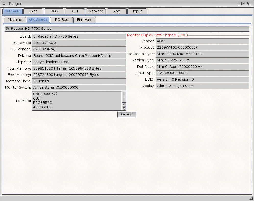

My configuration:
- GFX: RadeonHD 7700 / driver 2.21 - SFX: CMI8738 / driver 5.18

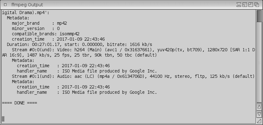

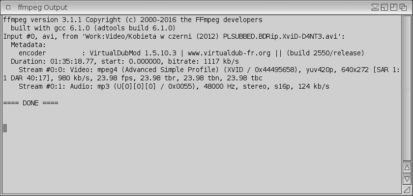

I have tested liveforit-mplayerng.lha (6.5.7) and liveforit-mplayer.lha (6.4) from OS4Depot. The funny thing is when I play "XivD AVI video" everything is ok: But when I took downloaded (ClipGrab) video form YouTube "h264" freeze always:

My Sam460ex config.
GFX: RadeonHD 7700 Series/ driver 2.21 (Actual card HD7750)
Soundcard driver
cmi8738.audio 5.17 (11/04/2006)
Soundcard driver
