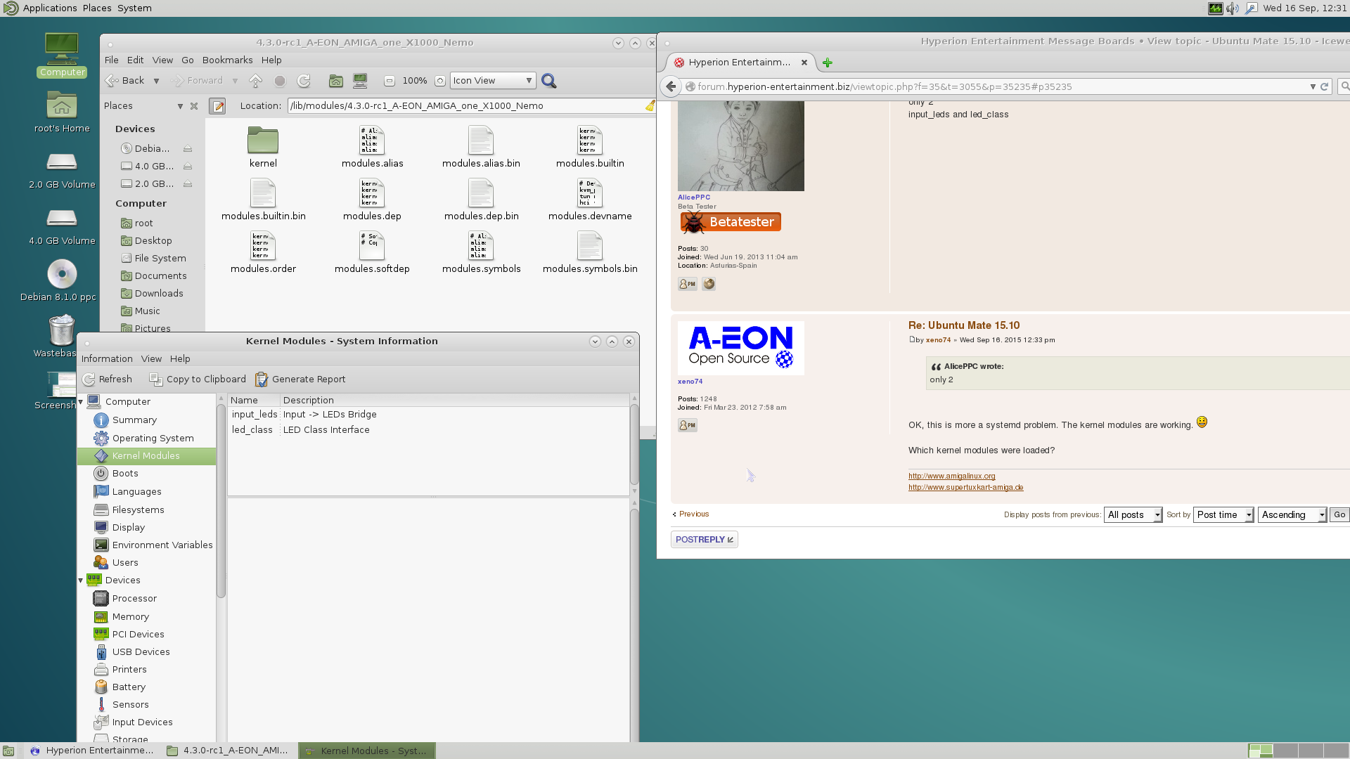

Humm...I have a problem loading kernel modules
How can fix this?
Posts: 11533
Re: Ubuntu Mate 15.10
AlicePPC wrote:Humm...I have a problem loading kernel modules
How can fix this?
Could you look in the section "Kernel Modules" of your system information program, please? I'd like to know if there some kernel modules were loaded.

only 2
input_leds and led_class
Posts: 11533
AlicePPC wrote:only 2
OK, this is more a systemd problem. The kernel modules are working. :-)
Which kernel modules were loaded?

Post by AlicePPC »
pic added
