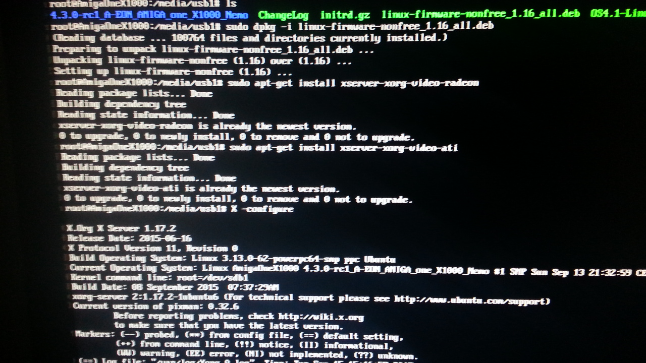

Same result..i download copy the archive to usb
enter in linux terminal again i mount the usb and execute...
See the pic
Posts: 11172
Re: Ubuntu Mate 15.10
AlicePPC wrote:Same result..i download copy the archive to usb
See the pic
Did you restart your X1000 after the installation of the firmware package?
