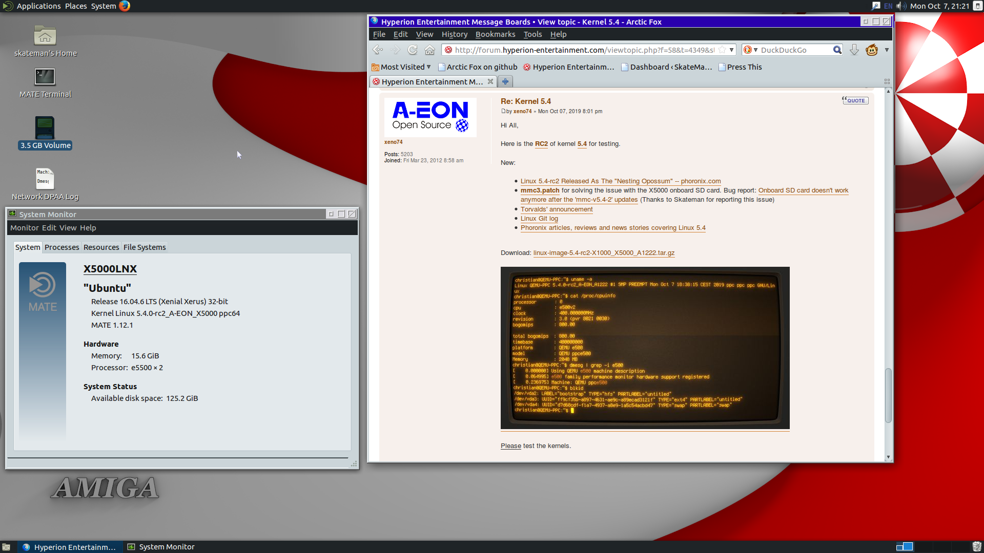

Here is the RC2 of kernel 5.4 for testing.
Download: linux-image-5.4-rc2-X1000_X5000_A1222.tar.gz
Posts: 513
Re: Kernel 5.4
Kernel 5.4 RC2 is up and running on the AmigaOne X5000
Big picture http://www.skateman.nl/wp-content/uploa ... 212110.png
Great work Christian!
Posts: 6190
Re: Kernel 5.4
Skateman wrote:Kernel 5.4 RC2 is up and running on the AmigaOne X5000
Thanks a lot for testing! Great to see that your onboard SD card works!
