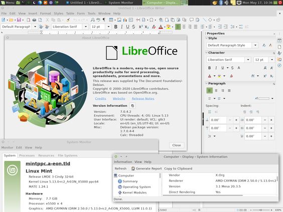

Posts: 602
Re: Kernel 5.13
Kernel 5.13 RC2 is up and running on my AmigaOne X5000
Big picture http://www.skateman.nl/wp-content/uploa ... 162745.png

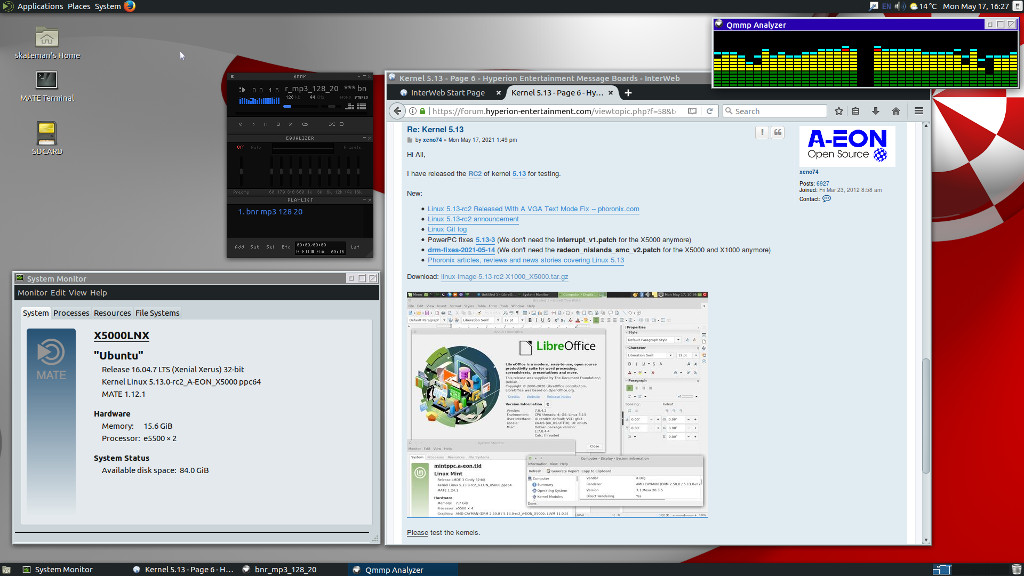

Posts: 821
Re: Kernel 5.13
RC2 working.
