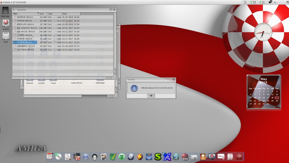

Re: Is it possible to use the TG-3468 with the X5000?
Posted: Sun May 19, 2019 7:42 pm
by Skateman
Checked and the version i have used with this card was 53.5 (see screenshot)
I have never had a newer version but had this card working for a long time without any issues.
