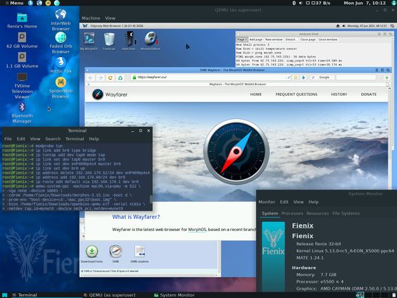

I have good news and bad news on RC5. Good is that I'm running Fienix now on the 5.13 RC5 kernel with no issues.
fienix@Fienix:~$ uname -r
5.13.0-rc5_A-EON_X1000_Nemo
