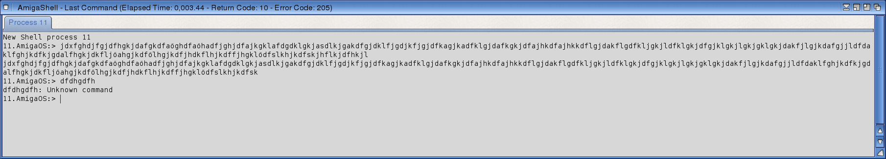

Hey there,
i wasn't sure if i should post a new thread, since it is so similar (and maybe even the same) to the bug i already posted, so i refrained from it.
I found (what i believe is) are two bugs and a potential new crash (but i'm not sure, if it is the same from above).
Here goes:
1st bug (command too long)
see attached screenshot
The "command" seems to overrun some buffer, which leads to the shell only displaying part of the copmmand, but no more.
No error messages (e.g. command not found), no nothing

I can tell you right now that #1 is because the shell CLI commandline buffer is maxed out at 256 bytes.
After that, it will just truncate anything else entered or stop accepting input altogether.
