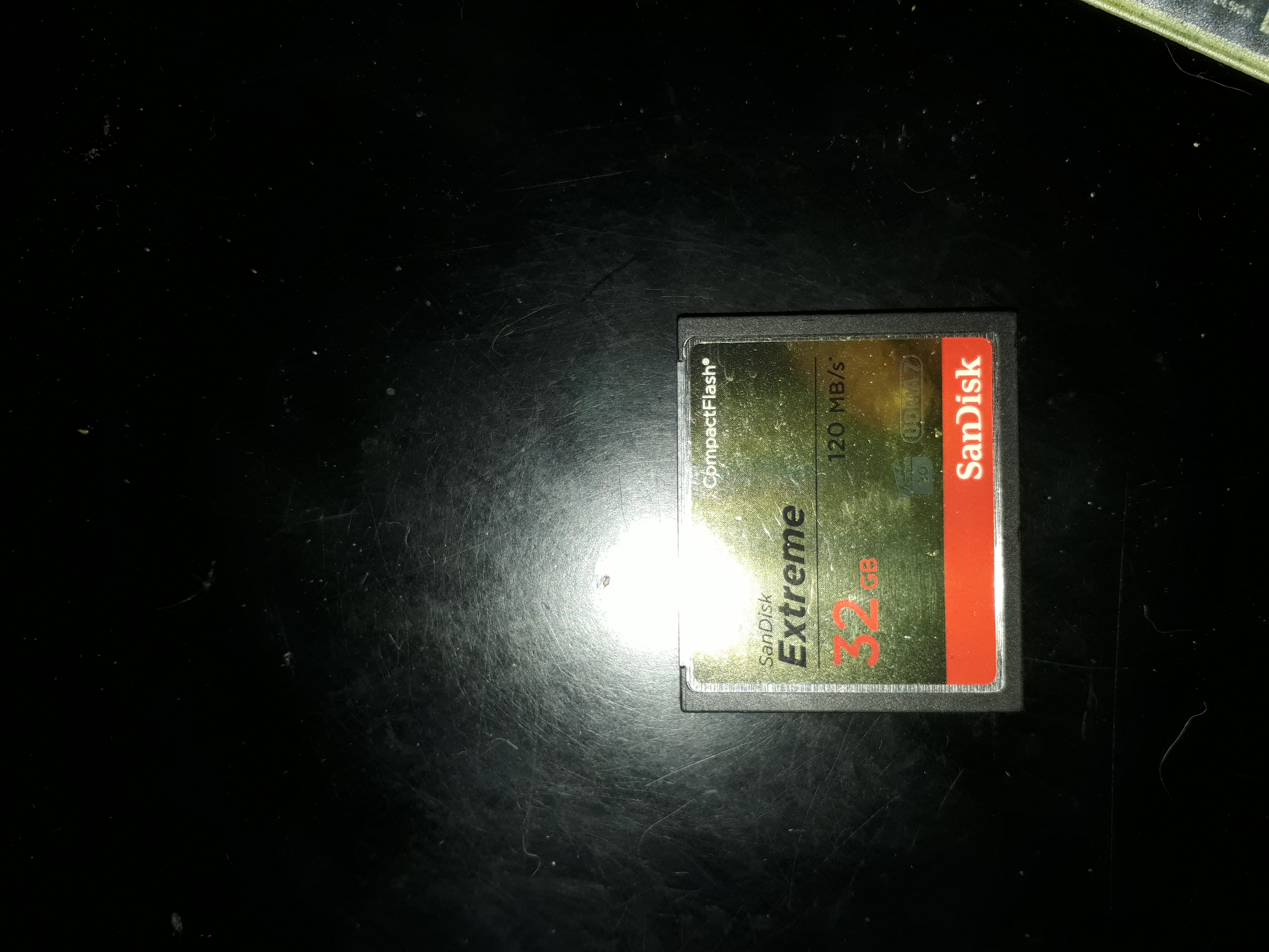

and here is my dmesg with new fast CF ( no errors, boot normally with zipped images)
Works with Debian8/4.2:
[    2.585914] ata7: PATA max PIO0 no IRQ, using PIO polling mmio cmd 0xf0000800 ctl 0xf000080e
[    2.779804] ata7.00: CFA: SDCFXS-032G, HDX16.01, max PIO4
[    2.779808] ata7.00: 62537328 sectors, multi 0: LBA48
[    2.779816] ata7.00: configured for PIO
[    3.254880] scsi 6:0:0:0: Direct-Access     ATA      SDCFXS-032G      6.01 PQ: 0 ANSI: 5
[    3.255322] sd 6:0:0:0: [sdd] 62537328 512-byte logical blocks: (32.0 GB/29.8 GiB)
[    3.255447] sd 6:0:0:0: [sdd] Write Protect is off
[    3.255454] sd 6:0:0:0: [sdd] Mode Sense: 00 3a 00 00
[    3.255509] sd 6:0:0:0: [sdd] Write cache: disabled, read cache: enabled, doesn't support DPO or FUA
[    3.257806]  sdd: sdd1
[    3.258296] sd 6:0:0:0: [sdd] Attached SCSI removable disk
and not work in Fienix/5.2

cf is not recognized at all.

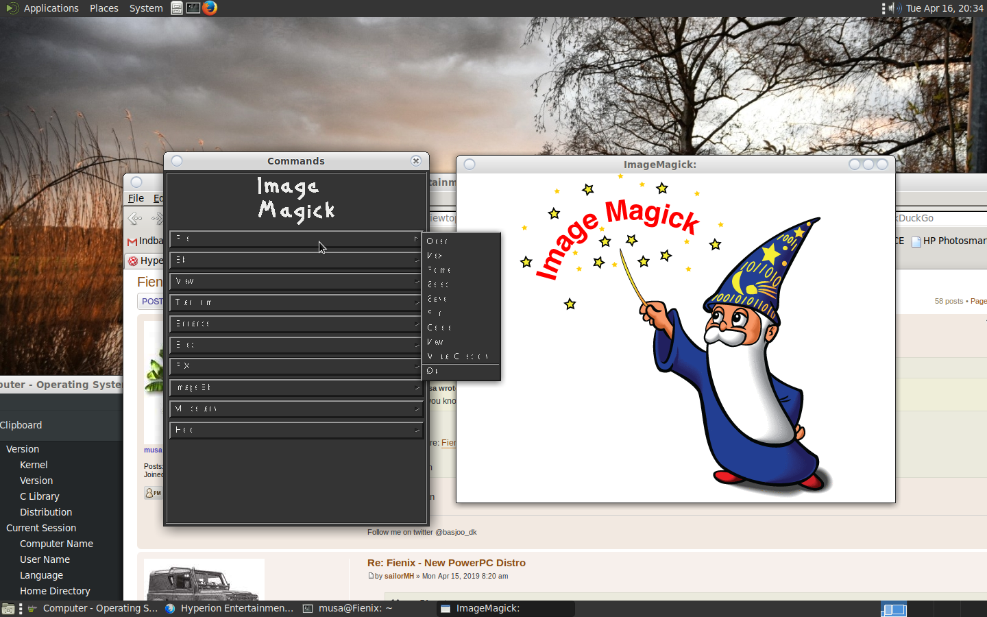

Hi Christian
When starting Image magick I got some problem reading the fonts.
Do you now what's wrong?
Is there a way change the fonts or is there a problem with some of my fonts.
it was the same problem I have when I try to compile Worker.
Musa

musa wrote:Hi Christian
Musa
Hi Musa,
I tested it today and I can confirm this issue.
@Casey
Could you please check Image Magick?
