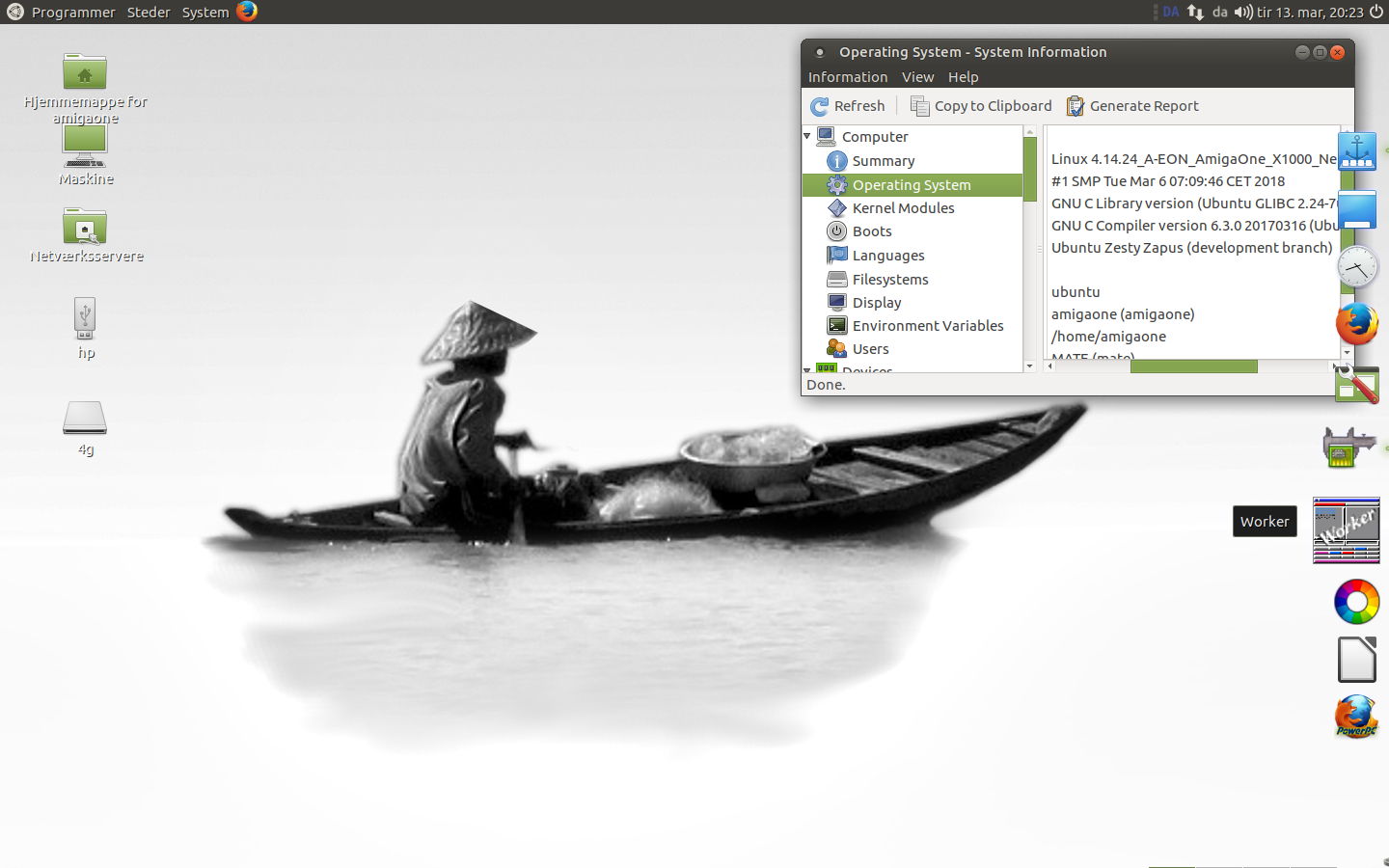

Postby musa » Tue Mar 13, 2018 9:38 pm
musa wrote:Hi Christian
Have tried to boot UBUNTU-REMIX-8 with vmlinux-4.14 and get this error
ran off end of fat chain!
fat entries should be >=2
Hi Musa,
I successfully tested the stable longterm kernel 4.14.24 on my AmigaOne X1000 today. It boots without any problems. I think it is a problem with your CF card. Could you please test the kernel 4.14.22 additionally?
Hi Christian
I have tried linux-4.14.22 and are getting this mistake
I Have tried linux-4.14.24 and it boots this time
Posts: 331
Re: Kernel 4.14
Postby xeno74 » Tue Mar 13, 2018 10:05 pm
musa wrote:I Have tried linux-4.14.24 and it boots this time
Hi Musa,
That's strange. You tested the kernel 4.14.24 first and you got an error. Today you tested the 4.14.24 again and it boots. Or did you test the kernel 4.14.22 first?
Posts: 4376
Re: Kernel 4.14
Postby musa » Tue Mar 13, 2018 11:24 pm
Hi Musa,
Hi Christian
The first time I try to boot 4:14:24 I got errors. I try several times on different partitions with the same result.
Today I tested 4.14.22 and got a kernel panic. Here too I tested several times with the same result.
Then I tested again 4.14.24 and it started the first time.
