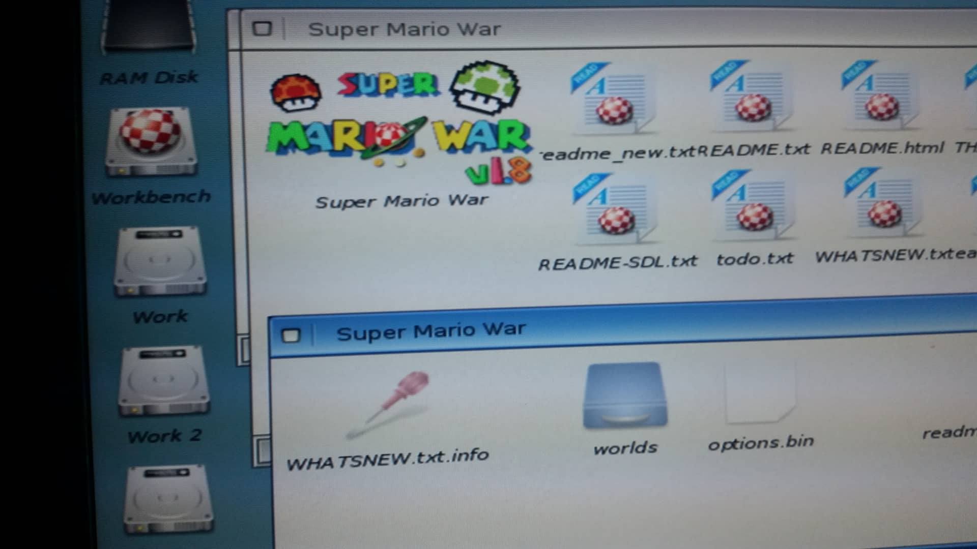

I tried VAMP from os4depot, copied the LHA to my HDD and depacked it and it DOES NOT COMBINE the files with the .info file. So I get ghost Icons from the program and a ghost Icon as .INFO. Normally, the .INFO should be the Icon for the Folder/file with the same Name. IS NOT.
I thought maybe it is the Archive. But now I have depacked it on my USB Stick (on PC) and it Shows fine ON THE USB. But when I copy all the files to the HDD, again, all Icons are just .info but not showing as usual. When I copy from HDD to HDD Partition, it seems to work normally.

Top: Before (USB) - bottom: after copying to HDD, all Icons are gone

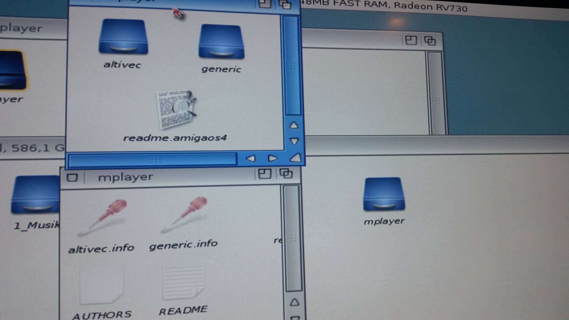

If show all files and show .info files (is that a beta feature? I lose track... ) are both enabled then the icons should show normally for the files they are associated with and as a second 'file' for the .info file.
The .info files in the mplayer grba appear to be showing as executables, which is very odd, unless the protection bots have been messed up.

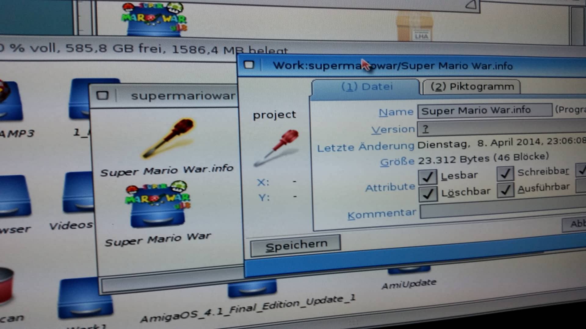

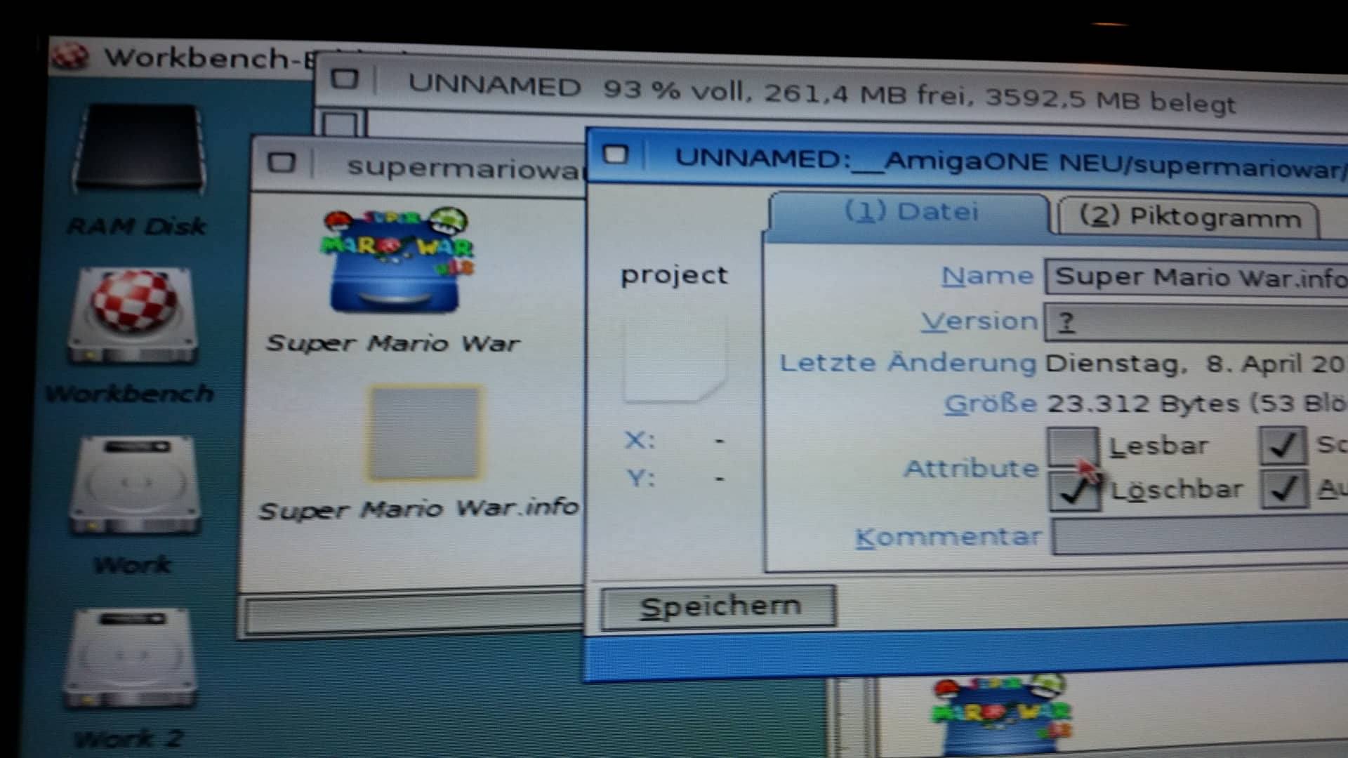

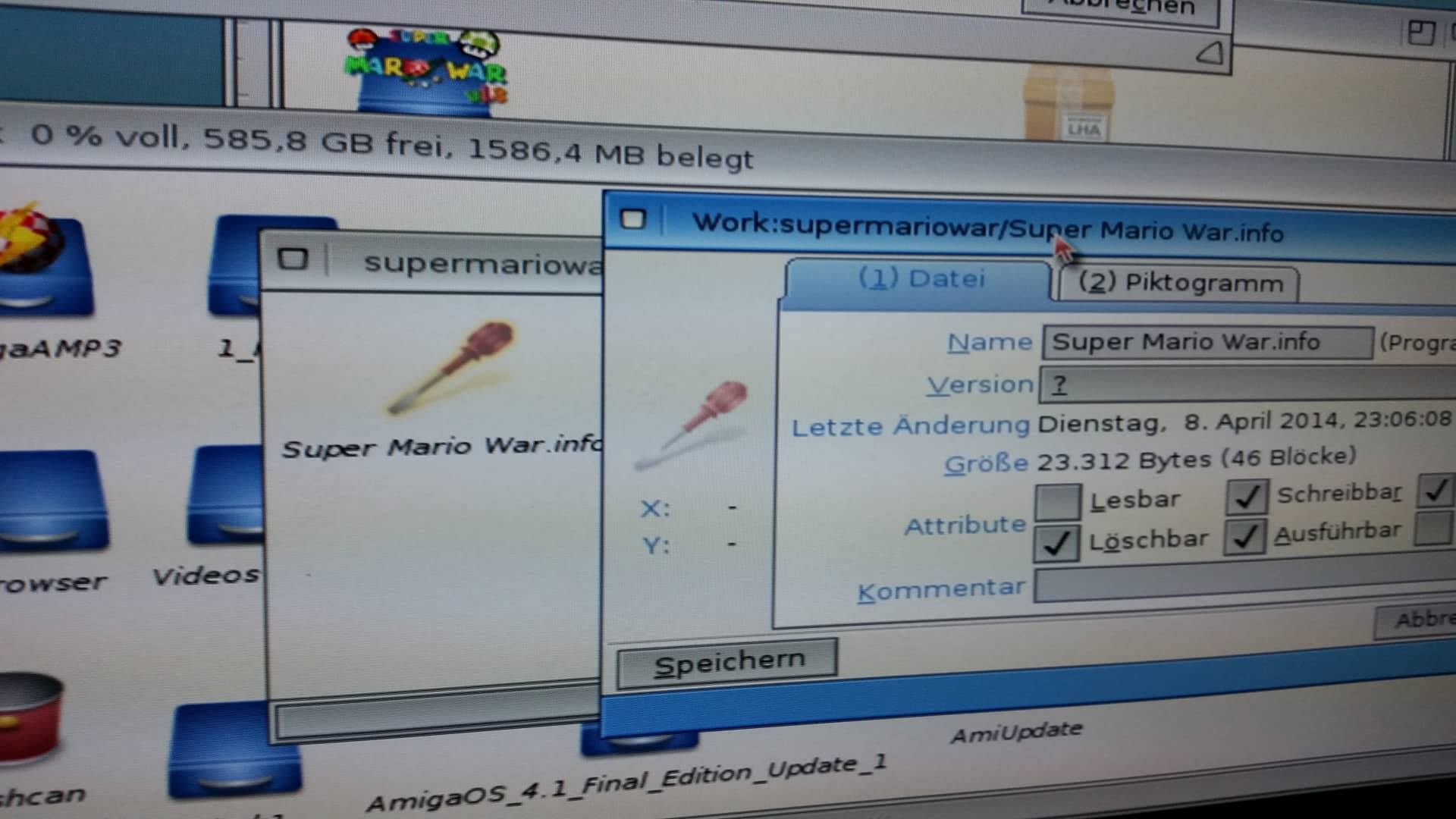

When I depack it on PC (Izarc) it shows the icon on the USB Stick on the Amiag ONE - BUT LISTEN: When I click "Show .info Icons" in the menu and go to Icon Information of the .info file, it is marked "NON READABLE". The Icon Information window has not tick/checkmark on the first Option, which is "readable". I use a German Translation so it could differ a bit from your menu.
When I now copy it to the HDD, the file disappears, as it is not readable (strangly, on the USB Stick it is readable?!?!? :?: ).
When I now mark the (seperated) .info file as READABLE and SAVE it, the Icon appears, BUT: The .info file does NOT DISAPPEAR. Very strange.

BUT THE READABLE BUG I examined, too:
All tests with a WORKING depacked Archive (all Icons etc. are there and okay)
When I mark the .info of the Folder as non-readable ON THE HDD, the Folder get's renamed to Super Mario War.info, turns into a PROJECT type, and there is a .info.info file, also (seems to be still the "original" .info file).
When I do the same on the USB Stick, Amiga OS creates a .info.info file, the drawer stays a drawer, and the Icon information seems to come from the created .info.info file. When I also set the .info.info to unreadable, it creates .info.info.info (I guess that is readable).
Here is the Video:
https://www.youtube.com/watch?v=xQBzD007z20
I personally think that this is a huge bug, because I never told it to make an .info.info file, I never told it to make my drawer to a Project, I never told it to act differently on USB and HDD. I don't get it.
IMHO, what it should do is: When I set the .info to unreadable it should act like it is not there or deleted, what means the drawer should stay a drawer, but get a Standard Icon (from ENV:Sys/ I guess) and only be visible when you set it to "Show all files".
That also explains, why it did not Show up on the HDD, while it indeed did on the USB Stick, because the non-readable .info files get treated differently relative to their Location. Experts would say it is not a "consistant way of doing something".
