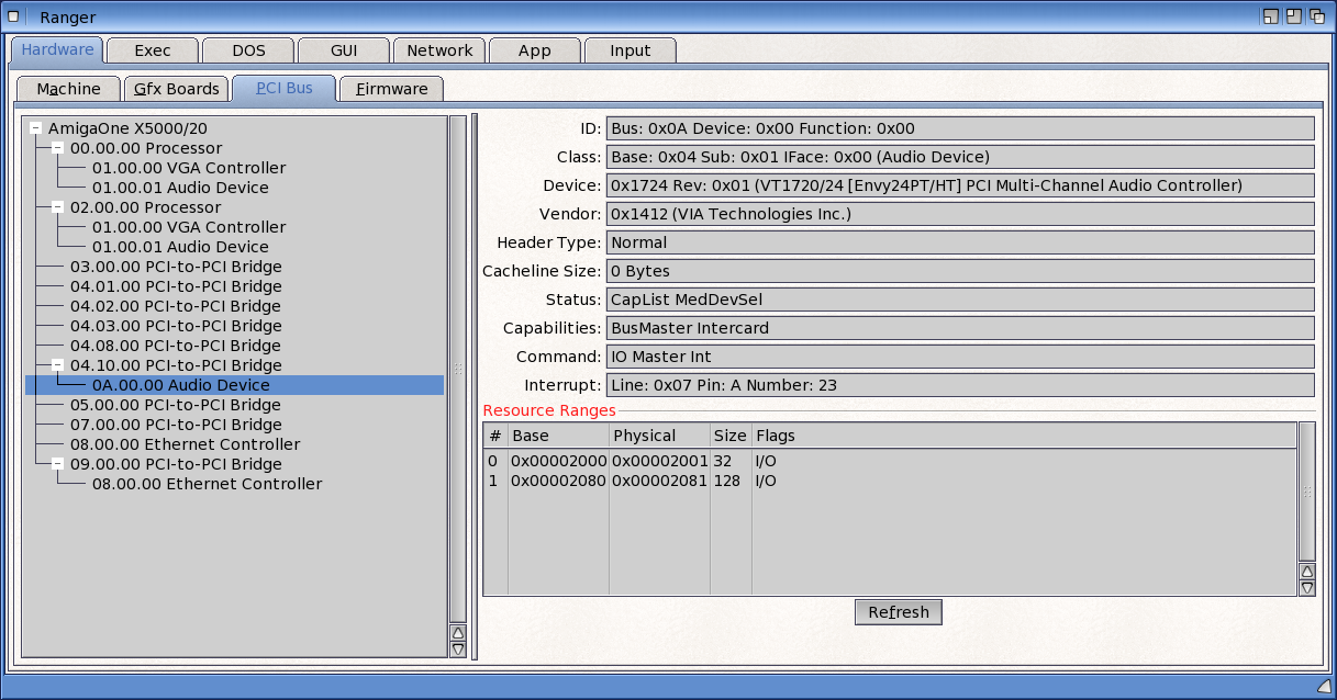

Postby Roland » Fri Jun 16, 2017 10:22 am
I am not at all familiar with audio cards, so I would like to ask... Is this card anyhow affected by the problems discussed here:
https://www.amazon.fr/KALEA-INFORMATIQU ... B00CI7D72G
The test program for which there was a link in Cyborg's earlier message does not recognize it, and AmigaOS Audio prefs sees it as a Envy24HT card.
Posts: 264
Re: Odyssey - YouTube - Offline Movies - system freezes
Postby Spectre660 » Fri Jun 16, 2017 4:07 pm
It is indeed an Envy24HT card.
These cards also have the bridge chip that have the problem with the CMI cards.
However based on my postings above some Envy24HT cards with the problematic version of the bridge chip (Revision 1)
may work . Mine is the only report of a version with the revision 1 chip working thus far though.

Postby Roland » Fri Jun 16, 2017 5:30 pm
Spectre660 wrote:It is indeed an Envy24HT card.
Is there some tool which can be used to check the chip revision on Envy24HT cards?
Posts: 264
Postby Spectre660 » Fri Jun 16, 2017 6:40 pm
Ranger.
The version that works on the X5000 is a comercial version available from A-Eon's Amistore .
http://www.amistore.net/
The info from Ranger :
viewtopic.php?f=57&t=3625&start=30#p40225
