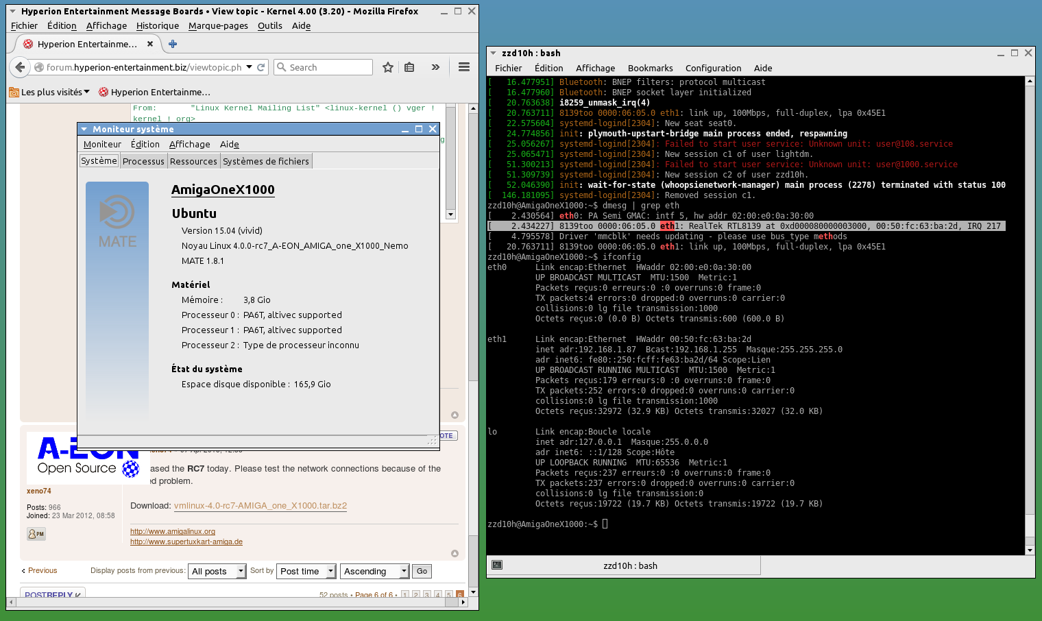

I released the RC7 today. Please test the network connections because of the solved problem.
Download: vmlinux-4.0-rc7-AMIGA_one_X1000.tar.bz2
Joined: Sun Sep 16, 2012 5:40 am
Re: Kernel 4.00 (3.20)
Post by zzd10h »
Yes, it works !
Nothing related, but since 2 or 3 kernel tests, I have to FAT32 reformat my CF with gparted otherwise CFE doesn't load the vmlinux-xx file.
Hopefully I have no problem with my USB stick.
Is somebody encounter this annoying problem ?
