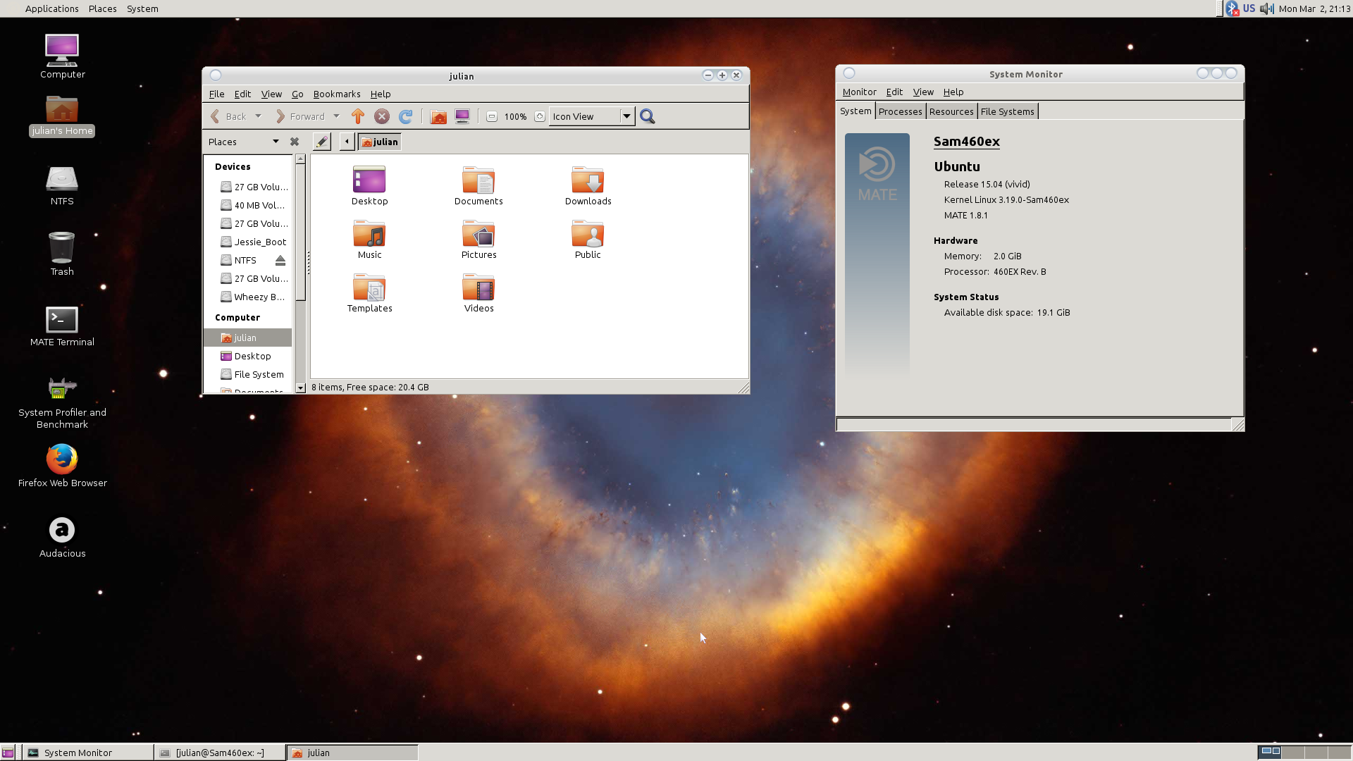

Postby Spectre660 » Sun Jan 25, 2015 8:41 pm
Lubuntu 15.04 Mate on Sam460ex .
Install Lubuntu 15.04 http://www.xenosoft.de/Sam_Lubuntu_15.04_Netinstall-1.ISO
then install Mate
sudo apt-get install mate-desktop-environment
Posts: 1489
Re: MATE
Postby Spectre660 » Sun Mar 01, 2015 9:32 pm
Ubuntu Mate Desktop is now an option with the Lubuntu 15.04 Sam installer.
Seems if if no Display Manager is installed by default so until yo install one X must be started manually .
Resorted to installing lubuntu-Desktop
apt-get install lubuntu-desktop

Postby Spectre660 » Tue Mar 03, 2015 2:26 am
seems that only one or the other can be selected or an error will result.
So opted for Lubuntu ,then will install Mate after from a LxTerminal .
Posts: 1489
Re: MATE
Postby Spectre660 » Tue Mar 03, 2015 3:19 am
Installed.
New default icon set.
Posts: 1489
