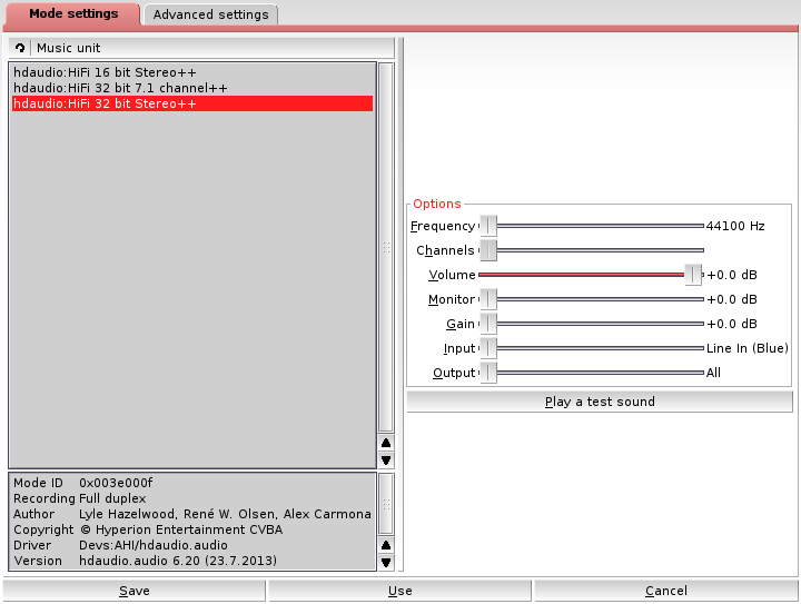

Postby austgarden » Sat Jul 05, 2014 2:30 pm
LyleHaze wrote:I am curious about missing both the front headphone and the S/PDIF.
(sorry for me beeing a bit unclear on the subject of the front headphone input , it's not missing i just didn't think to try it out , but it is working)
and the x1000 was / is suplied with pci sound card (this was in use until the HD audio driver was released)
so ewerything works fine just still not the S/PDIF out when using OS4.1 (I tried all the frequencies to) no luck
(s/pdif works on Ububtu remix on the X1000 no problem there)
I did at one point try to remove ewerything but the HDaudio from sys:devs:ahi
just so i could not select the wrong one in ahi prefs .
I set all AHI prefs options to the same settings as this picture
ahi prefs

Postby LyleHaze » Sat Jul 05, 2014 5:06 pm
Thanks very much for the photos, that goes a long way towards checking all the details along the way.
If the other four units are set the same as the music unit shown, then the only other thing I can think of would be the difference between LPCM and AC3 formats.
AC3 is a Dolby format, which I don't have access to.
I wish I could be more help.
