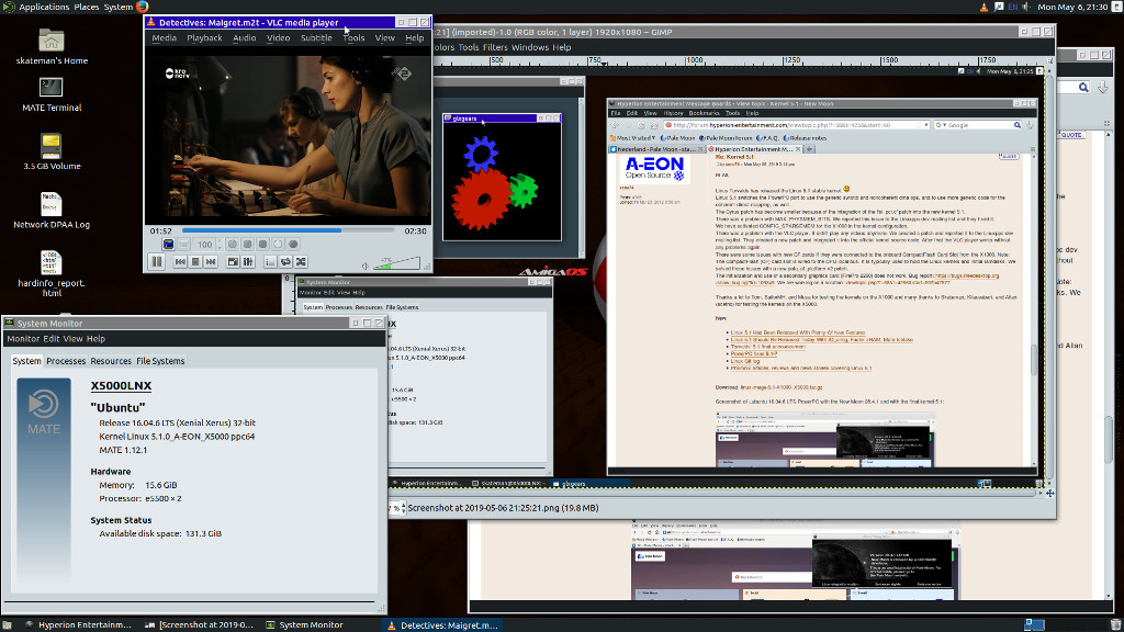

Final kernel 5.1 up and running on my AmigaOne X5000. Many thanks for all the hard work you have put into it Christian (and all who contributed)!
Big picture http://www.skateman.nl/wp-content/uploads/2019/05/Screenshot-at-2019-05-06-213042.png
