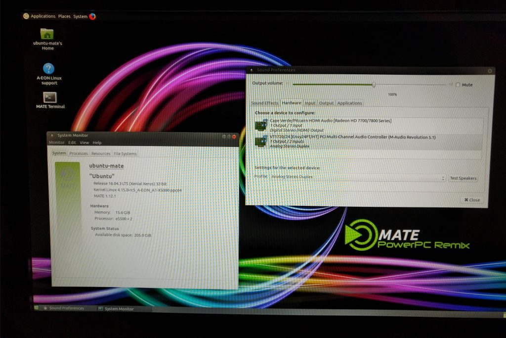

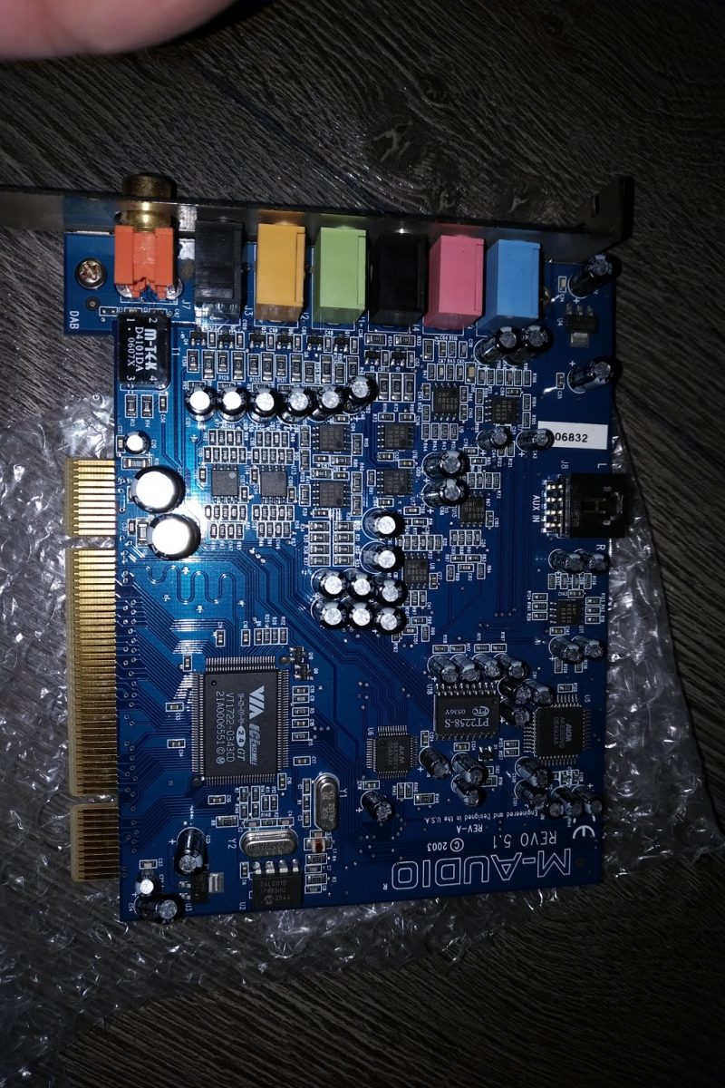

Today i replaced my Soundblaster live for an M-Audio Revolution 5.1 soundcard. I have bought this card secondhand and guess what?
With more than 4 GB ram the M-Audio works great!
NOTE: Revolution 5.1 audio cards have been designed to be PCI 2.2
compliant with support for both 3.3-volt and 5-volt PCI signaling
environments. This guarantees compatibility with PCI-X, 64-bit, and standard
32-bit PCI-based systems, including the Apple G5.
This is the Card with a EnvyGT chipset, and works in OS4.1 FE as well!! :-)
So if you need a good soundcard... look for an M-Audio Revolution 5.1
