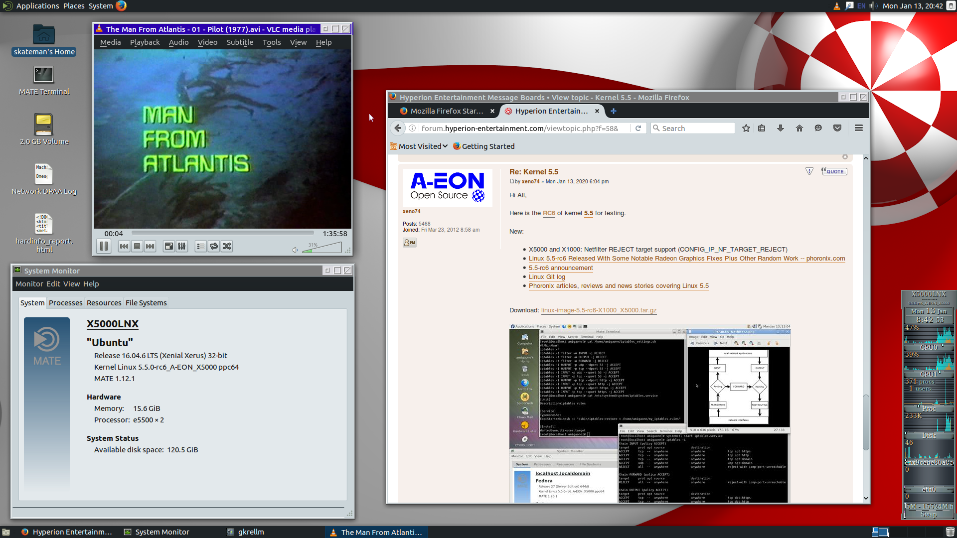

Re: Kernel 5.5
Kernel 5.5 RC6 up and running !
Big picture http://www.skateman.nl/wp-content/uploa ... 204252.png
