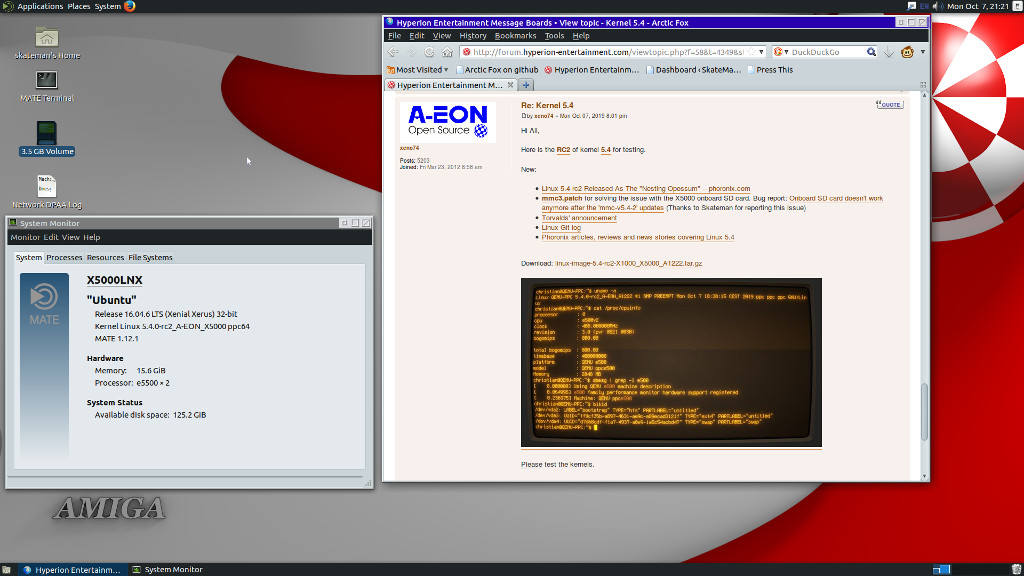

Posts: 980
Re: Kernel 5.4
Kernel 5.4 RC2 is up and running on the AmigaOne X5000
Big picture http://www.skateman.nl/wp-content/uploa ... 212110.png
Great work Christian!
Posts: 11521
Re: Kernel 5.4
Skateman wrote:Kernel 5.4 RC2 is up and running on the AmigaOne X5000
Thanks a lot for testing! Great to see that your onboard SD card works!
