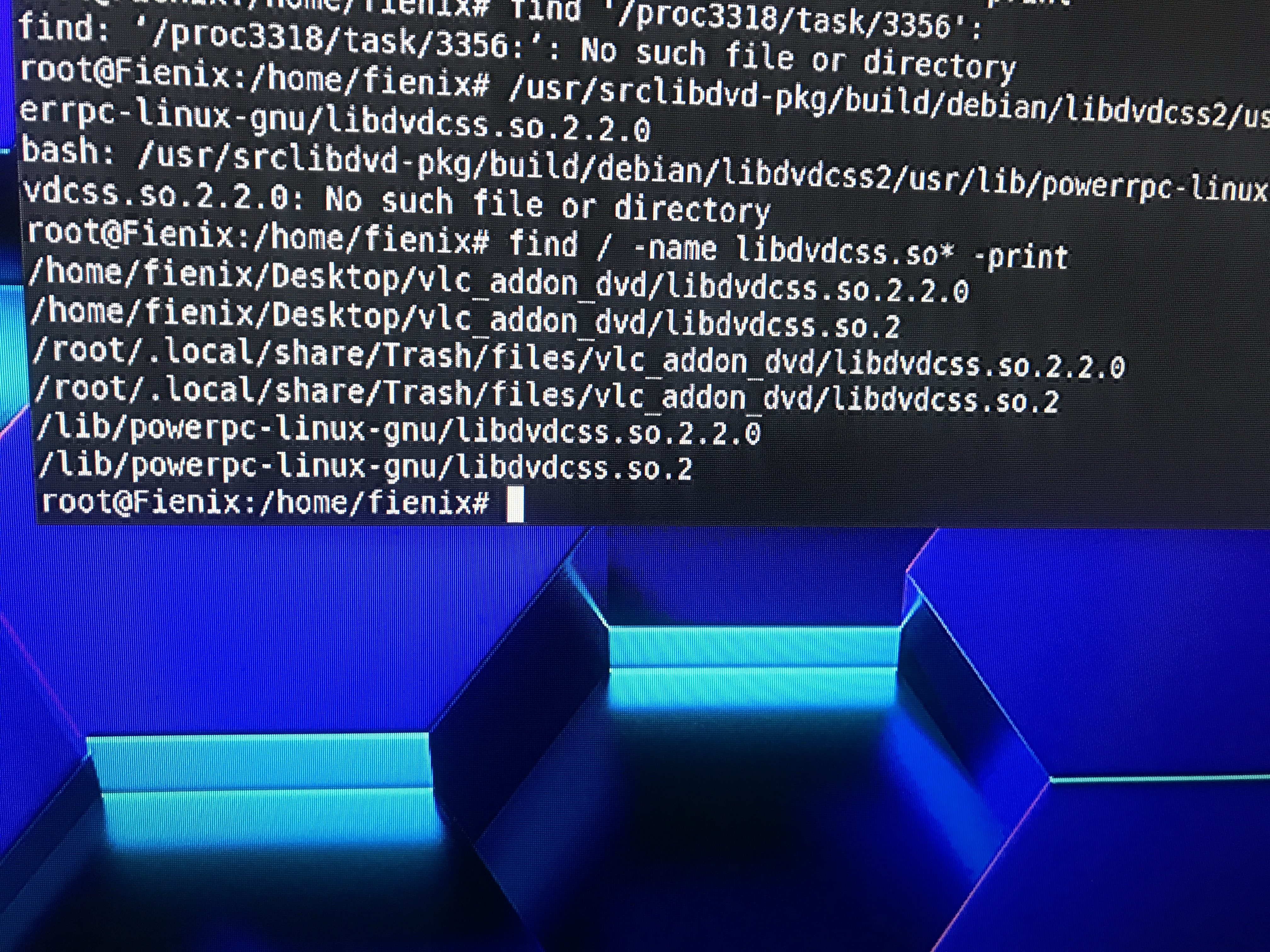

Post by Tijatjj »
Hi, trying to install the dvd package and here’s the printout?dont know what is going wrong or how to finish install thanks,also how do you install something from repository and run it

Tijatjj wrote:Hi, trying to install the dvd package and here’s the printout?dont know what is going wrong or how to finish install thanks,also how do you install something from repository and run it
It looks good so far. Could you please test a DVD with the VLC? If you want to install something from the repository then use Synaptic. (Click on Menu, Administration, Synaptic)

Post by Tijatjj »
Ok starts this play but screen jumps to different sizes.its a Radeon sff7750 .i have a r7 240 if that would be better thank you you’ve

Hi Tijatjj,
Unfortunately you can’t use hardware acceleration with your graphics card. You need a Radeon HD 6xxx or lower.

Post by Tijatjj »
Thank you,any particular chipset to look for.is that what is hanging up the dvd playing . I am guessing there’s no way to shutdown the hardware acceleration.
