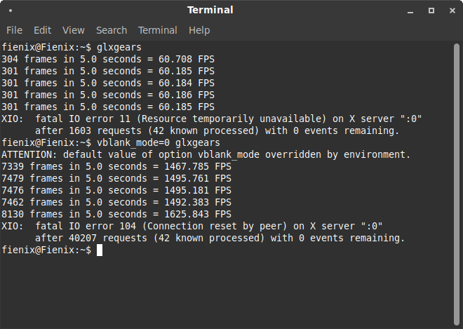

I ran the gears demo to check 3d & only got 60fps, so not working with my 4850 gfx card, any ideas?
Could you please post the output of vblank_mode=0 glxgears?

Ran glxgears first with no options, ~60fps.
Second run was vblank_mode=0 glxgears, ~1500fps.
Reading up on the vblank_mode, default would be 60, so guessing 3d is working.
glxgears
glxgears
Posts: 11170
sundown wrote:Ran glxgears first with no options, ~60fps.

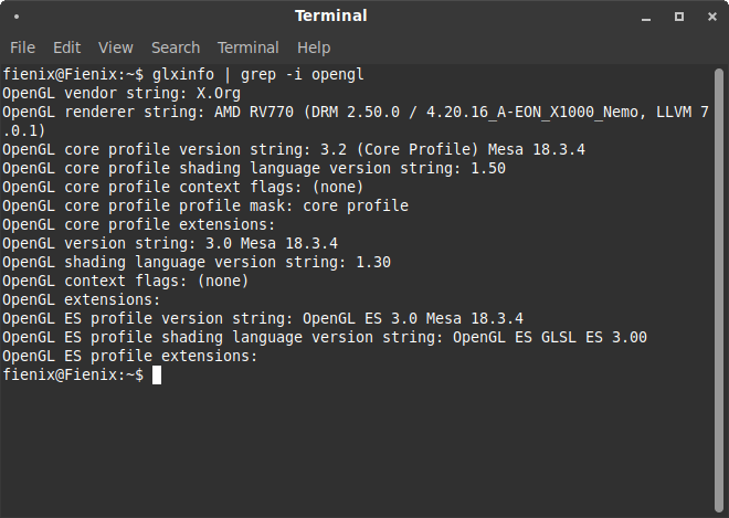

It looks good. Please post the output of glxinfo | grep -i opengl.

glxinfo
glxinfo
Internet isn't working, have an rtl8169 card that works with Mate 16.04, need to figure that out before Fienix is useful.
I was lucky to find a post that gave the root permission password (rootAdminPW) to even try to edit things.
Also, like another user, Fienix boots up without the home icon & nothing works, was wondering if I should try another
kernel, seems I have 4.20.16 installed now.
