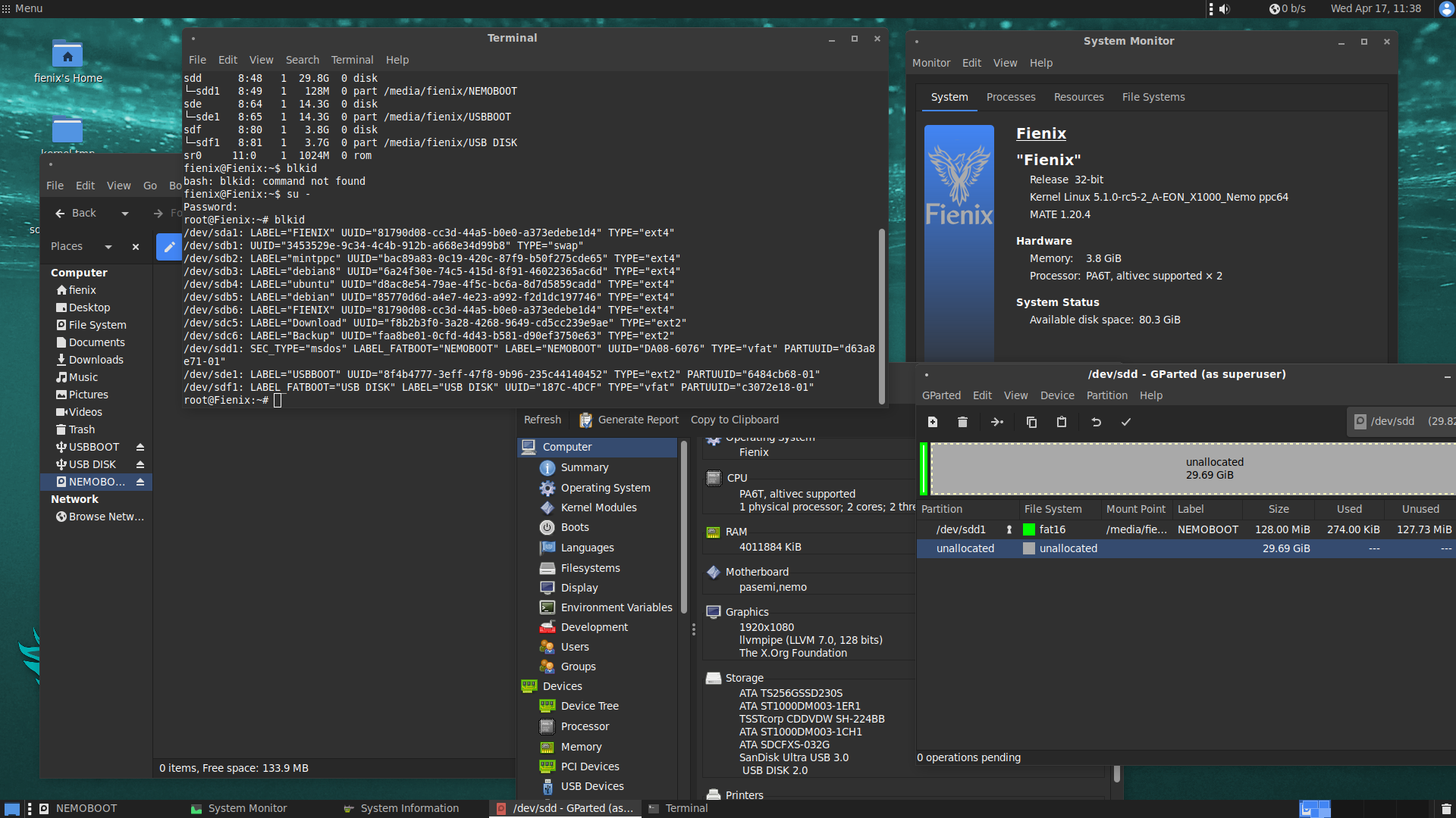

I successfully tested it with my 256MB SanDisk CF card connected to the onboard CompactFlash Card Slot today.
Screenshot:
